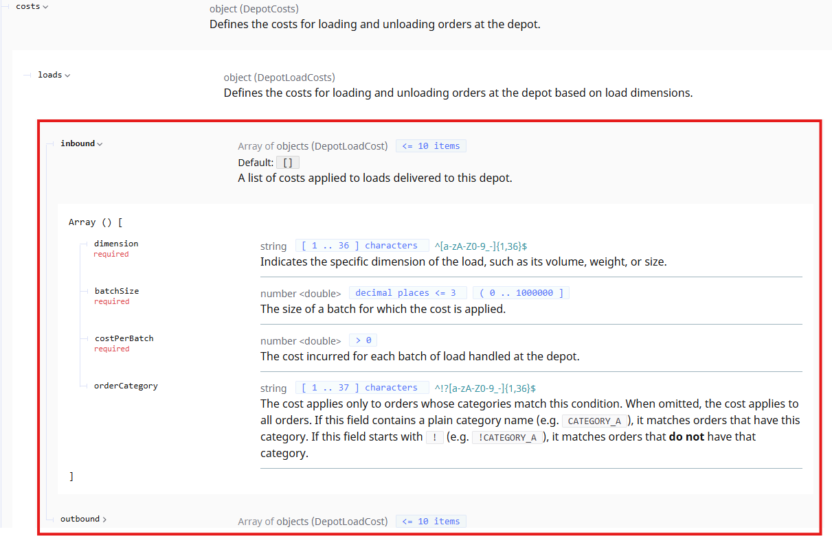

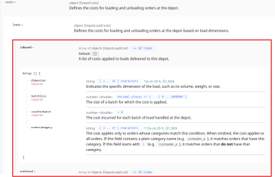

  • Per Depot
    • .costs.loads:(v 1.55 / 20.3.2026) - inbound (A list of costs applied to loads delivered to this depot) and outbound (A list of costs applied to loads picked up at this depot) - Defines the costs for loading and unloading orders at the depot based on load dimensions:
      • dimension - Indicates the specific dimension of the load, such as its volume, weight, or size.
      • batchSize - The size of a batch for which the cost is applied.
      • costPerBatch - The cost incurred for each batch of load handled at the depot.
      • orderCategory - The cost applies only to orders whose categories match this condition. ...

Re: Potential Cost factors in Route Optimization API
Added inbound / outbound depot costs for load at a depot location
