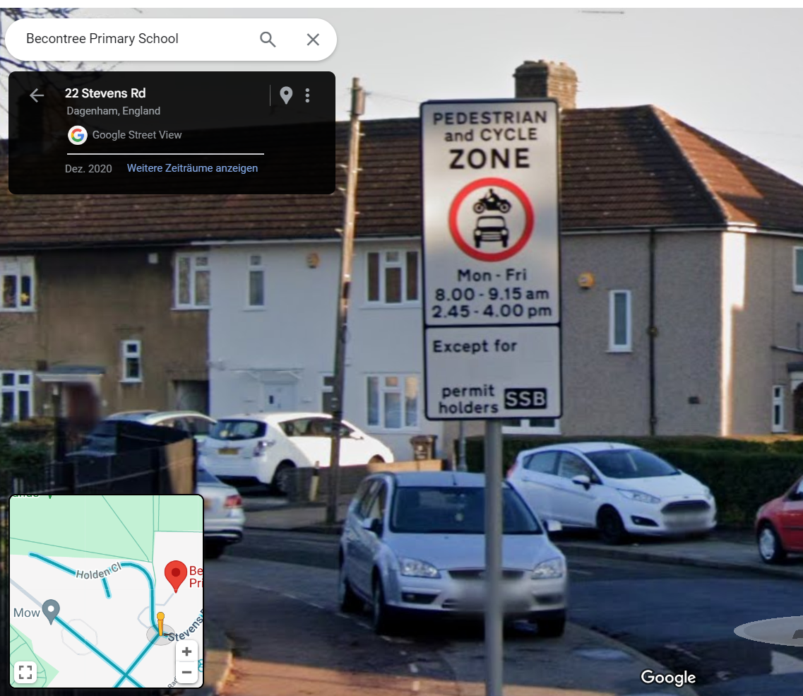

This GDF time domain's meaning is:
  • [[(t2){d5}]*[(h14m45){h1m15}]] : weekdays between 14:45 - 16:00
  • [[(t2){d5}]*[(h8){h1m15}]] : weekdays between 08:00 - 09:15
Here's an example from this school list - the Becontree Primary School:
Becontree Primary School <br />(51.5566370, 0.1175894)

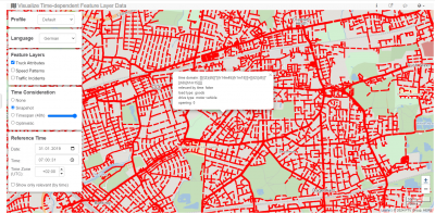

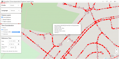

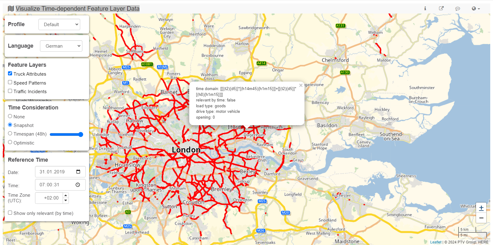

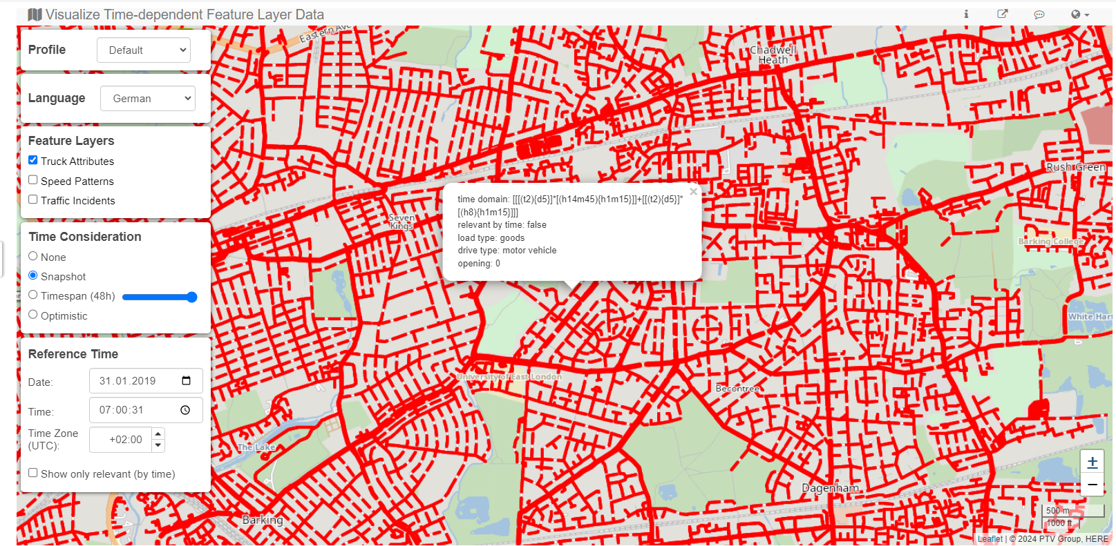

The following screenshots are based on the xServer2 Visualize Time-dependent Feature Layer Data Showcase
Area displayed in very rough level
Area displayed in rough level
Area displayed in close level
