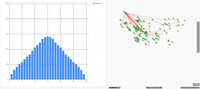

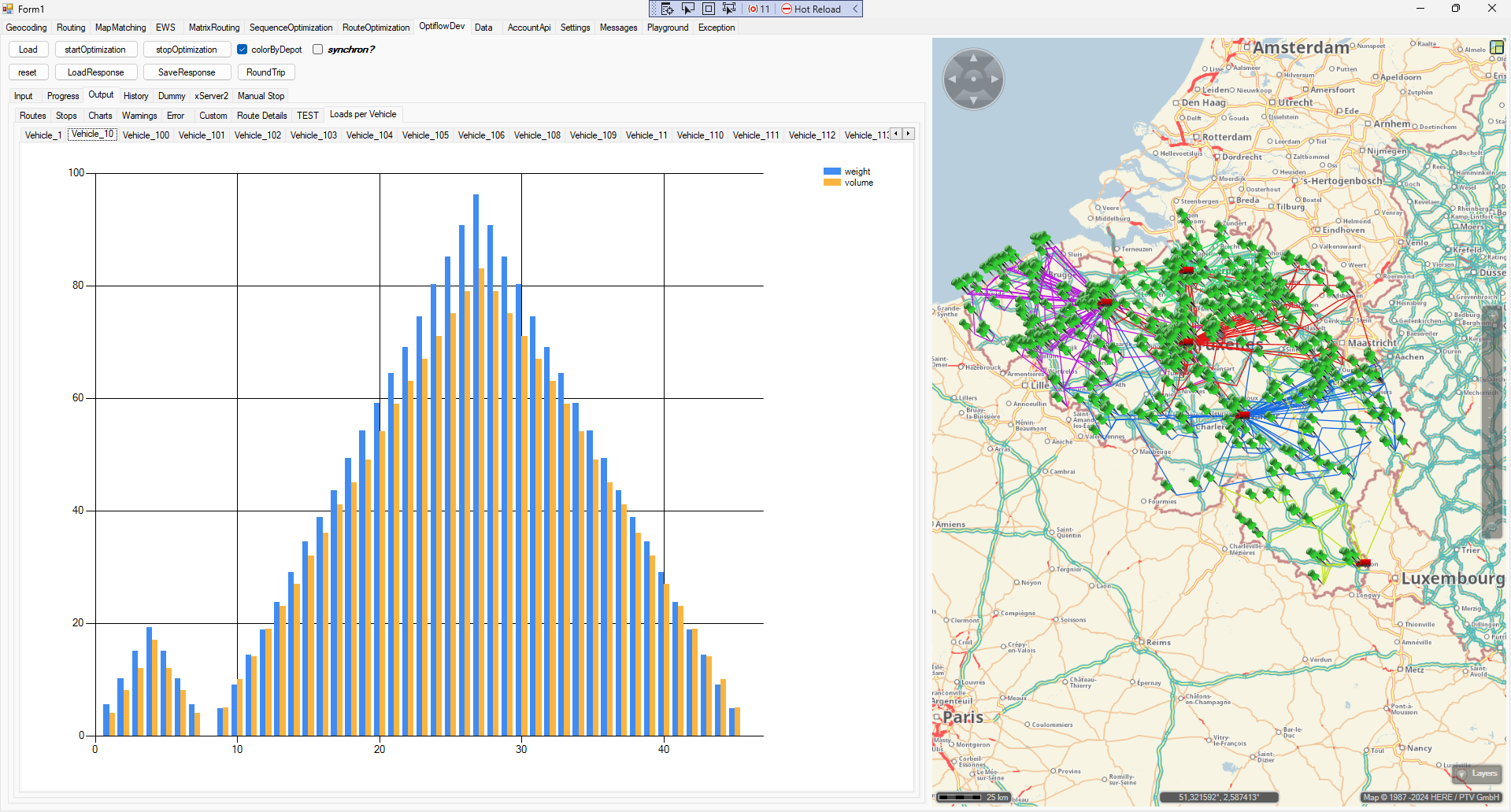

Now in this example the vehicle servers multiple trips - one of them with insufficient load. Sidenote: the planning call considers two dimensions at the same time. The bars acome along side by side.
Visualization of a ehicle utilization. In this particular vehicle the one and only load dimension shows a maximum  load condition of less than 50% which is probably insufficient. <br />But also the map shows the geographic situation: the unscheduled orders are too far away from the depot and can't be reached at all.
