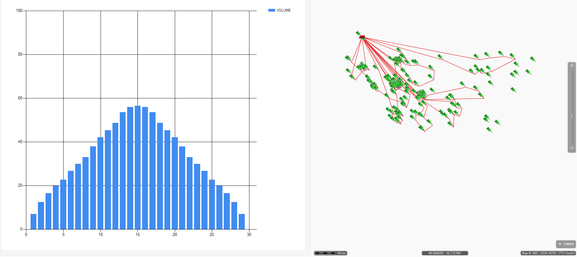

Now in this example the vehicle servers multiple trips - one of them with insufficient load. Sidenote: the planning call considers two dimensions at the same time. The bars acome along side by side.
Visualization of a ehicle utilization. In this particular vehicle the one and only load dimension shows a maximum  load condition of less than 50% which is probably insufficient. <br />But also the map shows the geographic situation: the unscheduled orders are too far away from the depot and can't be reached at all.

Response 1 ( refers to the underlying case of the screenshot where the map is disabled )
Just had a quick look at the sample request and I think the main issue is the input in this case. The total volume of all orders is equal to 15552, spread out over 188 orders which are situated across the south of X-land. For an average load of 1700 per vehicle all orders would need to be executed by 9 vehicles or less. Given the distance constraint (1100 km max) and to a lesser extent the timing constraints this doesn’t really seem feasible in my view.
Response 2
With the features currently available in DAPI I’m afraid the only real way to try and prioritize individual vehicle utilization over trip efficiency is fixed costs and as you mention this will not work across multiple subtours.
Limiting the number of allowed subtours to 1 using the grouping workaround (assigning all orders to a single consecutive group) would be a way to avoid a case like the one you mention but of course this other far reaching effects on the planning.
