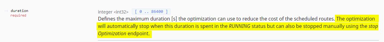

You can set a preferred calculation duration, allowing the algorithm to halt automatically after the specified time. If you have a sequencing request containing only one vehicle with up to 500 orders, the calculation duration is capped at 2 minutes as sequencing requests are faster to optimize.

As announced for v1.27.0 there is a now an additional "exit" feature given via the settings.maximumStagnationDuration:
So this means if there's no progress for a certain period of time the optimization might get stopped before the settings.duration is expired.integer <int32> [ 1 .. 86400 ]
Defines the maximum duration (in seconds) the optimization may continue without improving the best-known solution. If no better solution is found within this period, the optimization will stop early - even if the overall duration limit has not yet been reached. This mechanism helps reduce unnecessary computation time when progress stalls. The stagnation timer starts when the optimization enters the RUNNING status and resets each time a better solution is found. Use with caution: This feature may prematurely terminate optimizations that could still yield better solutions given more time. Since the timing of improvements is inherently unpredictable, relying on this setting can lead to suboptimal results. It is recommended to disable this feature or set a conservative value unless you have strong reasons to limit runtime based on stagnation.
