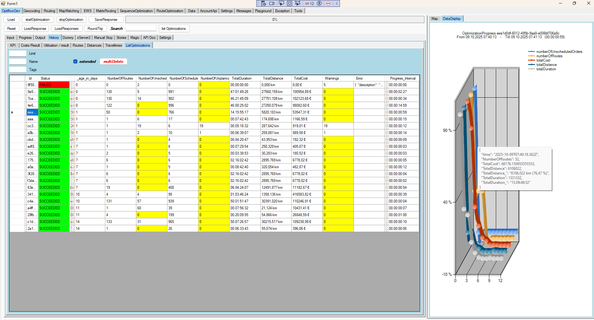

Awesome - meanwhile we added some convenience functions and I created a little admin frontend which enables me to
Very helpful - thanks!
- jump through the planning history
- visualize various KPIs
