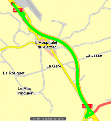

As a result we receive the following plan:

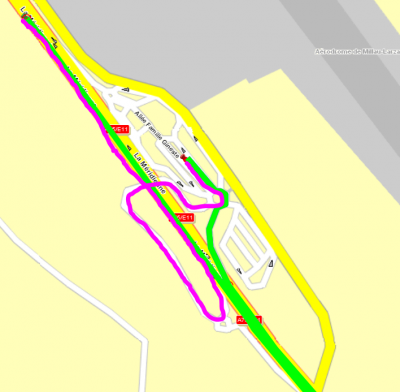

When I checked with Map&Guide I saw no restrictions on the desired road (drawn with purple) which is the following one:
Whats the reason for that huge detour?

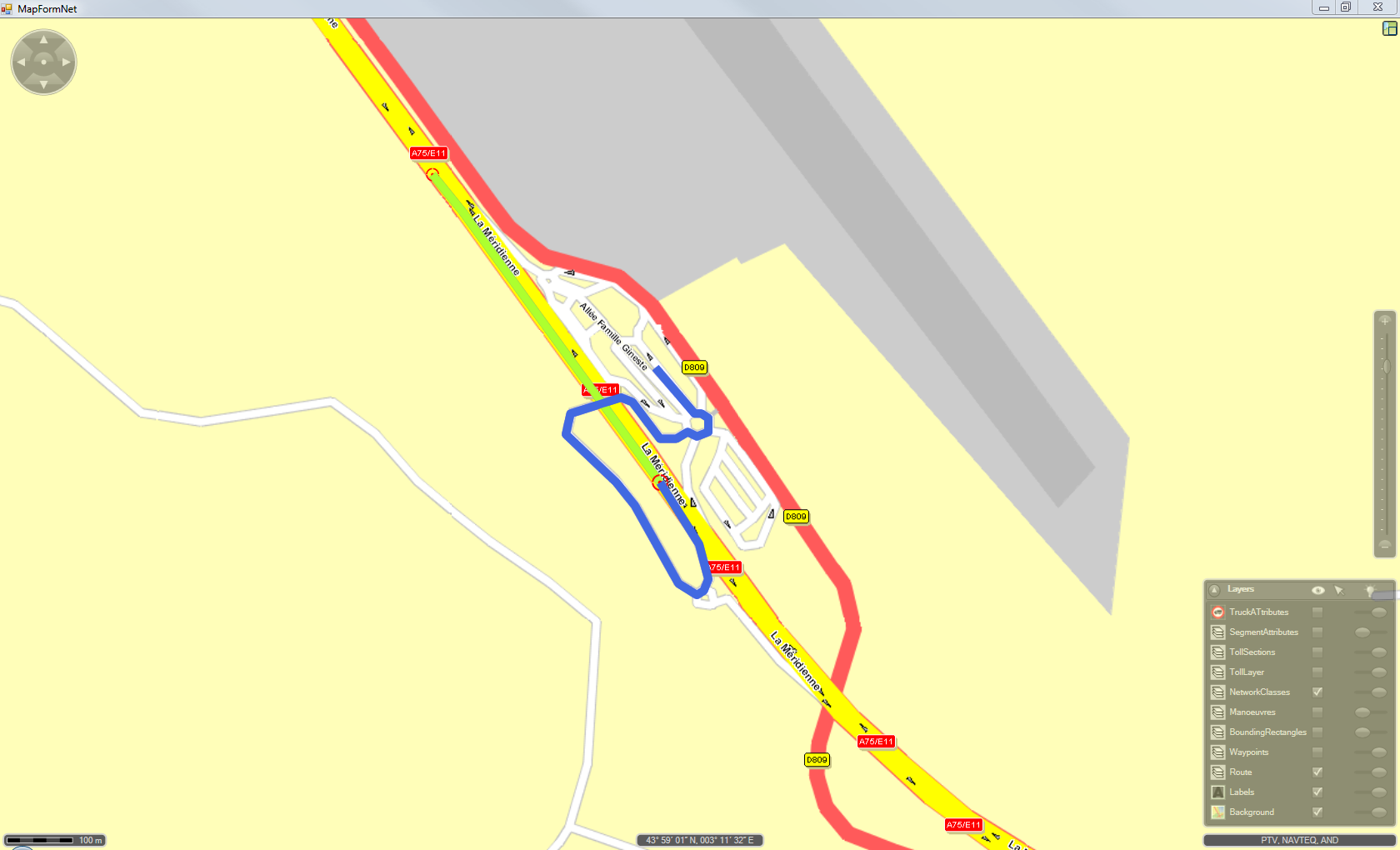

the attached screenshot gives us the required information:
Blue segments: RESIDENTIAL attribute
The segment in blue colors belong to RESIDENTIAL category. So if you apply a malus to that street segment category the routing prefers a detour. If the malus is at 2500 (highest acceptance value) this means the routing accepts a detour that is up to 25 times as long as the original segment.

The screenshot is based on AVOID_RESIDENTS_ONLY=0
(= I don't care whether a segment is RESIDENTIAL or not)
I think this is the mising link ;-)
If not: let me know!!
Regards Bernd
