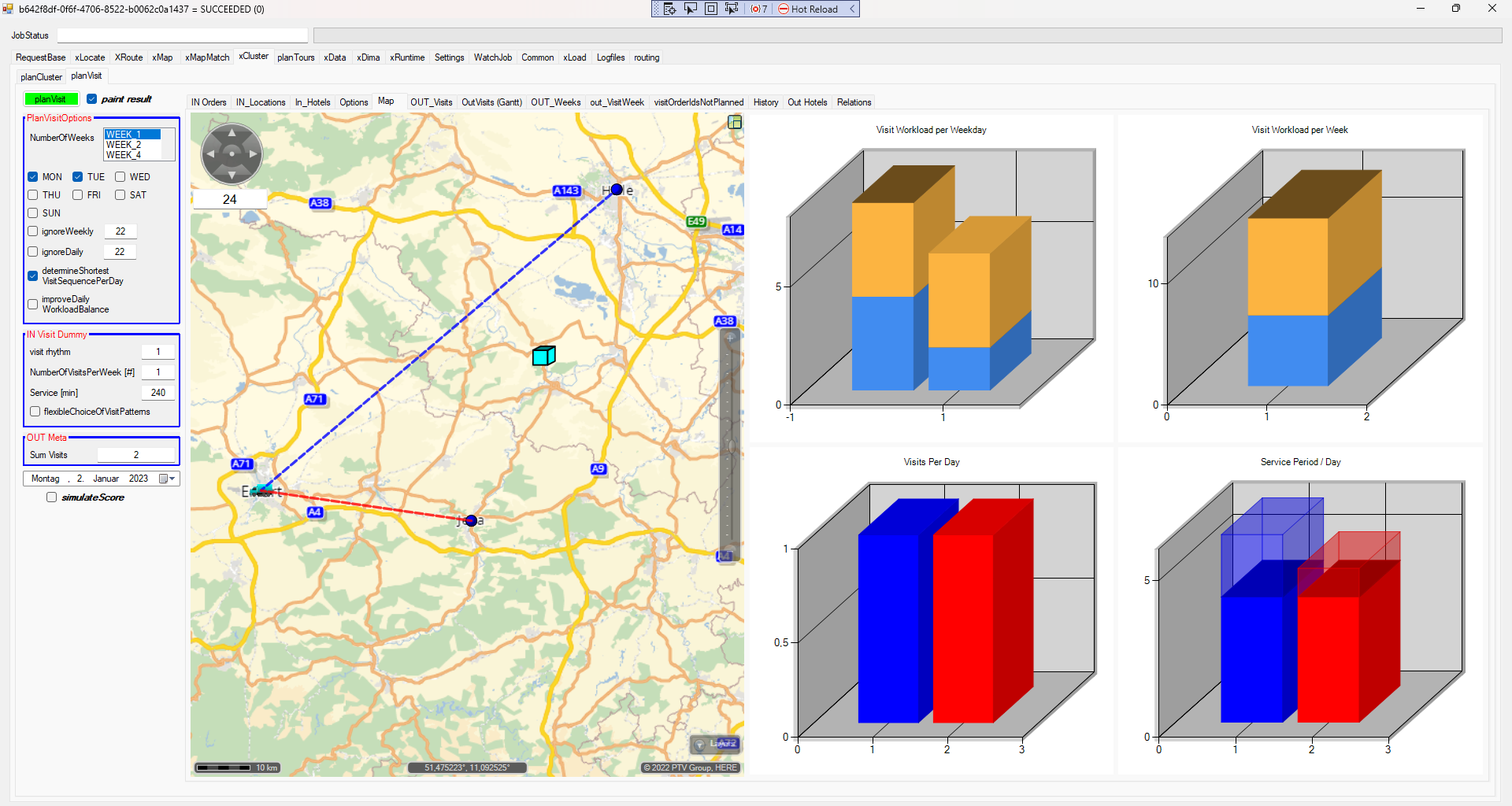

I've been asked for the criteria that applies when we have to decide about an overnight stay in xCluster's planVisit. Here's an example:
Here's the direct comparison. By staying in the hotel it is pssible to save about 1:30 traveltime - with equal service times for both scenarios.

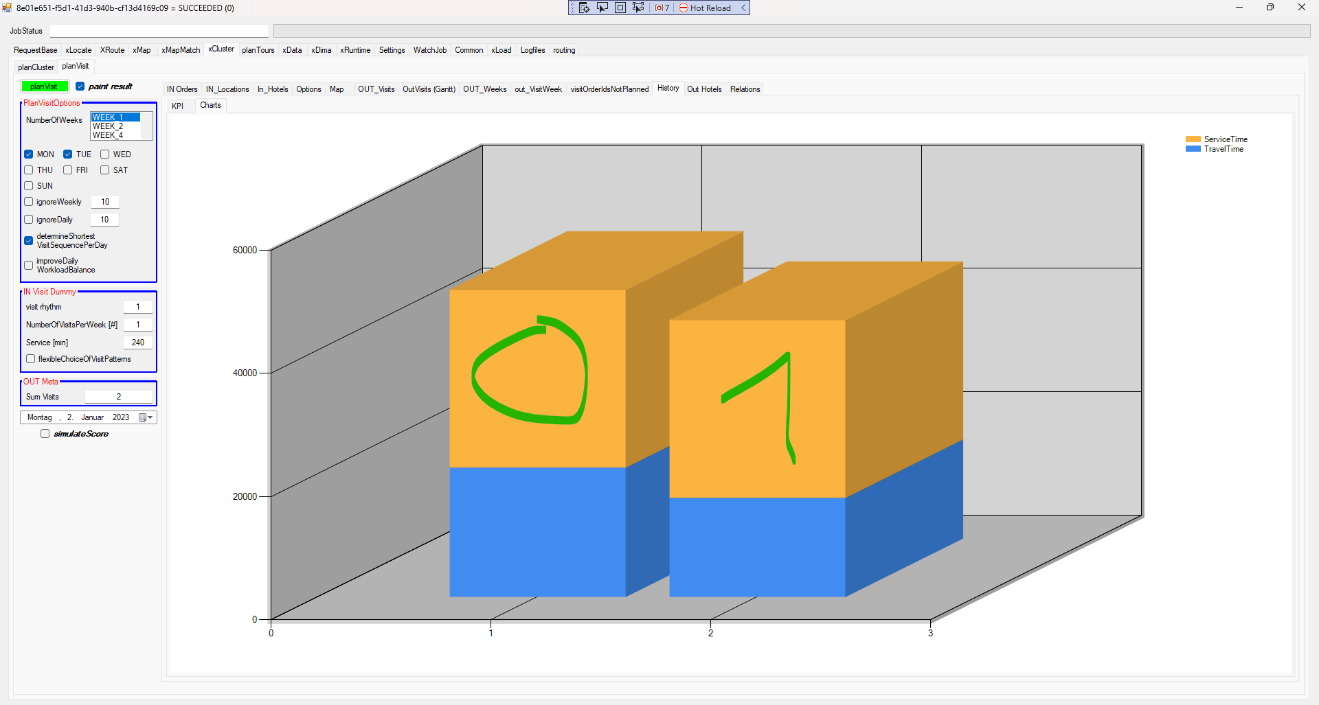

And here are the detailed views:
  • In this example the decision is "drive back home"

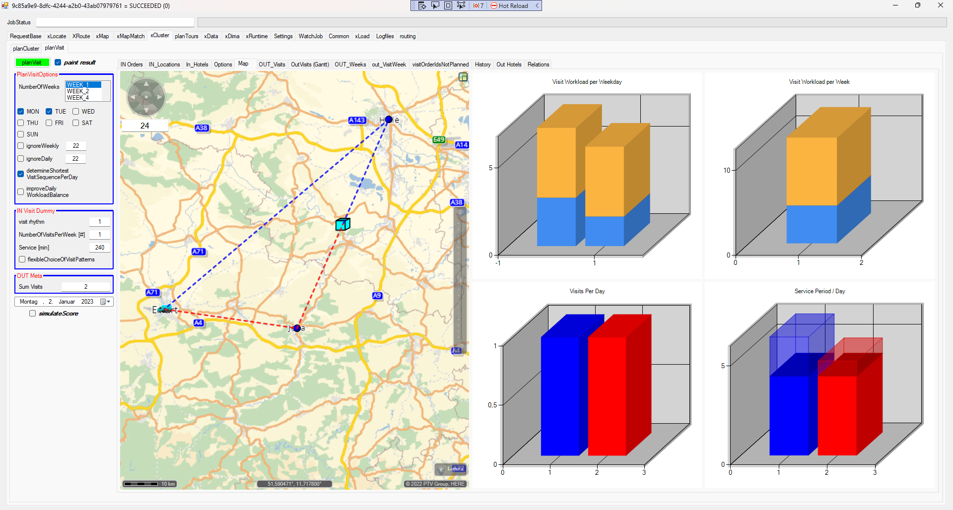

  • Here the decision is "stay at the hotel"

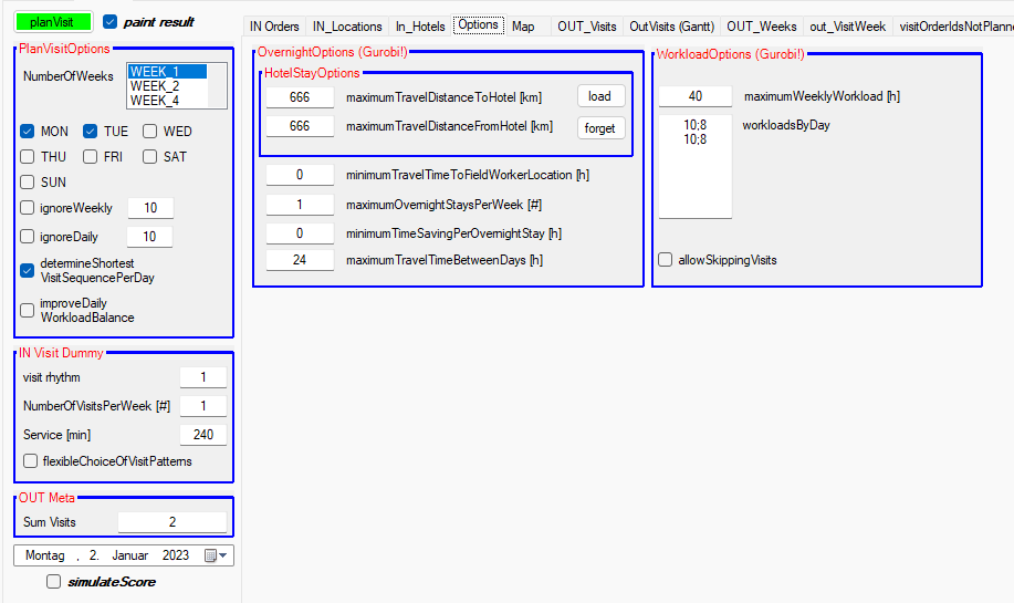

The behaviour is controlled by the OvernightStayOptions which are defining some threshold values that are checked when potential sequences with / without hotels are compared.
:!: in xTour1.planOvernight we used to apply some cost driven factors such as "costs per overnight stay" which were applied together with a drivers costsPerKilometer and costsPerWorkingHour. This approach isn't used anymore.
Sample settings...
Sample settings...
