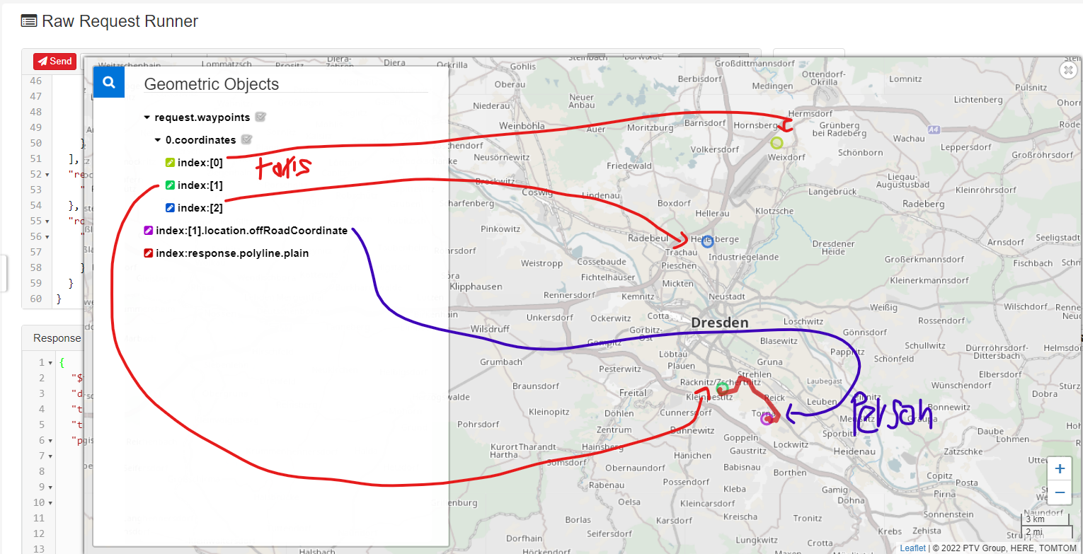

these days I've been challenged by several players with some performance topics. Their story was compareable and after some discussions with DEV I am super excited that Max dragged my attention to this approach outside the box.
Here are the constraints:
  • Person needs a taxi at (x,y) as quick as possible
  • Several taxi positions (x,y) are known
  • Distances are compareably low, maybe preselected
  • Both historical and live data are required
  • Quality should match "ExactAtStart" behaviour
When I discussed the story with the partners based on different "dima driven approaches" we ran into different topics:
  • XDima2.CreateDistanceMatrix doesn't support ExactAt..Consideration
Here's the new approach / idea:
RED= 3 potential taxis waiting for a customer.<br />The closest one is picked. No info about the other two taxis returned.
