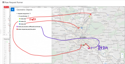

Here's the new approach / idea:
RED= 3 potential taxis waiting for a customer.<br />The closest one is picked. No info about the other two taxis returned.

  "waypoints": [
      "$type": "MultiCoordinateOnRoadWaypoint",
      "coordinates": [
          "x": 13.79165398,
          "y": 51.152859002
          "x": 13.743576969,
          "y": 51.01651402
          "x": 13.730742916,
          "y": 51.098036026
      "$type": "OffRoadWaypoint",
      "location": {
        "offRoadCoordinate": {
          "x": 13.782697007,
          "y": 50.999312007
  "resultFields": {
    "polyline": true
  "routeOptions": {
    "timeConsideration": {
      "$type": "ExactTimeConsiderationAtStart"
