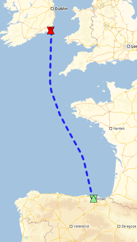

I assume you refer to the current TOMTOM map (https://xroute-eu-n.cloud.ptvgroup.com/xroute/ws/XRoute). At least the HERE map shows a connection between Bilbao/Algorta and Rosslare. (CHeck Screenshot below)
OK, here's how to proceed with such (no-)findings :
PS: If you are dealing with the 2022.2 HERE map it might be helpful to change the boat penalty.
- please open a regular support ticket and let my colleagues know that you are desperately looking for the mentioned connection (I can't do this for you, sorry).

Yes, we use Tomtom maps.
I have also used boatPenalty for forcing.
On the other hand, I searched with GetSegments (by SegmentsByCoordinateRequest, -3.0684206, 43.3509482 port of Bilbao) and the only result was:
"Bilbao-Portsmouth".
Thanks, I will open a support ticket.
