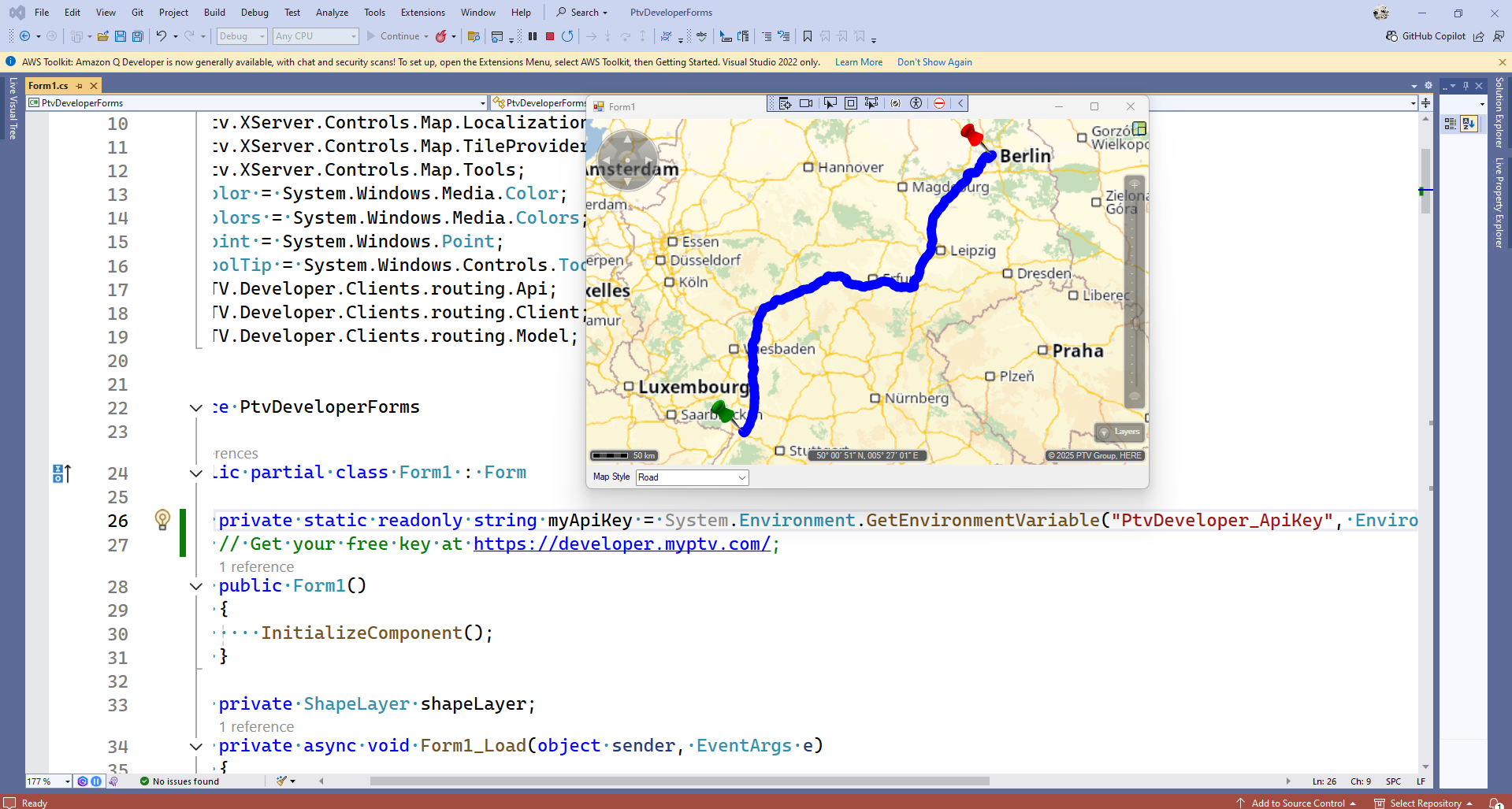

Sensei Oliver created a sample project for you: https://github.com/oliverheilig/PtvDeveloperForms

Sample Projtct - I am using the windows system to provide the API key. The sample project then computes a route polyline and visualizes it together with symbols for start and destination waypoint.
