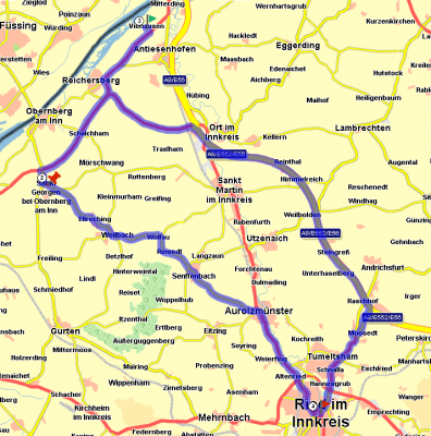

I have a problem with Guided Navigation. When i open our bcr.file with the PTV Navigator, the Navigator show not the route, i want for the vehicle. I have attached the file with a hardcopy, which route i want or i have exported in the bcr.file.

the waypoints are fine. Here we face the problem that the map provider differs. The route is probably planned on HERE, and the Navigator is running with TomTom. Close to the first destination the waypoints are mapped on a street segment with truck restrictions. Although a guided navigation route, the navigator is of course considering the truck restrictions.
Two options:
1. use car profile for this dedicated BCR
2. change map provider on the navigator to HERE and set the following value within the BCR in the section CLIENT:
FORGETWEAKLORRYRESTRICTIONS=1
