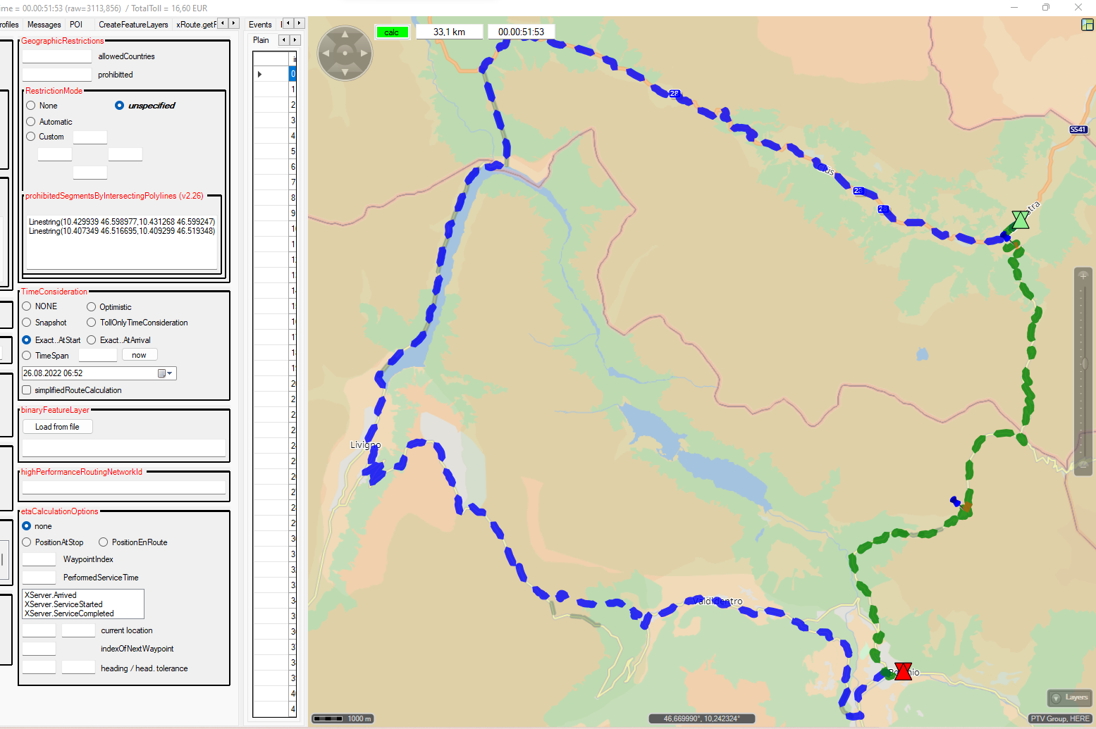

The screenshots below use the GeographicRestriction. I manually gathered geographies at the entrance of the passes. the blue pins show the position of the "blockings"
:idea: Feel free to provide further relevant sections. Thanks to Beat for the trigger ;-)
Umbrail Pass between Santa Maria and Bormio<br />Linestring(10.429939 46.598977,10.431268 46.599247)<br />Linestring(10.407349 46.516695,10.409299 46.519348)<br />https://en.wikipedia.org/wiki/Umbrail_Pass

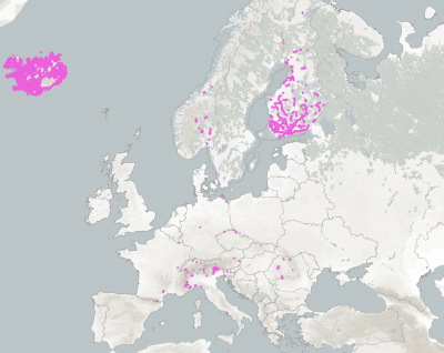

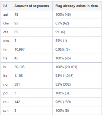

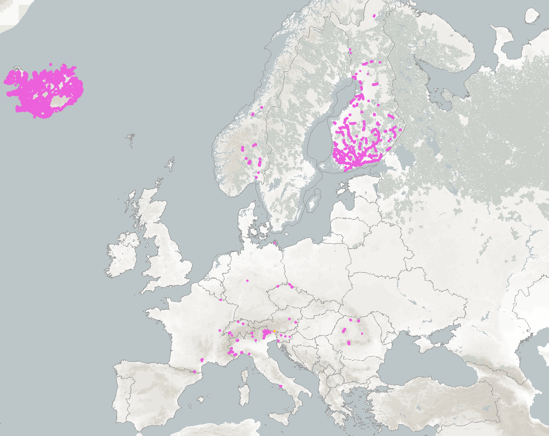

Just found this image based on 2018 TOMTOM data ;-) Nice coverage!
statistics
statistics
visual...
visual...

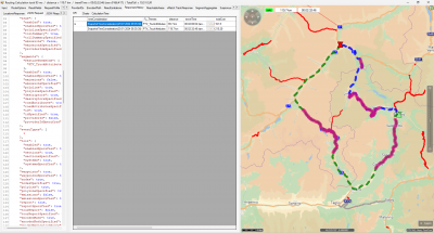

Re: How to block roads in winter (mountain passes)?
The routing from Bormio to Zernez. As there are time dependent PTV_TruckAttributes the time consideration has an impact on the geometry. I calculated the routes for 29.7.2024 and 29.01.2024 (windter - blocked)
