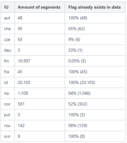

Just found this image based on 2018 TOMTOM data ;-) Nice coverage!
statistics
statistics
visual...
visual...

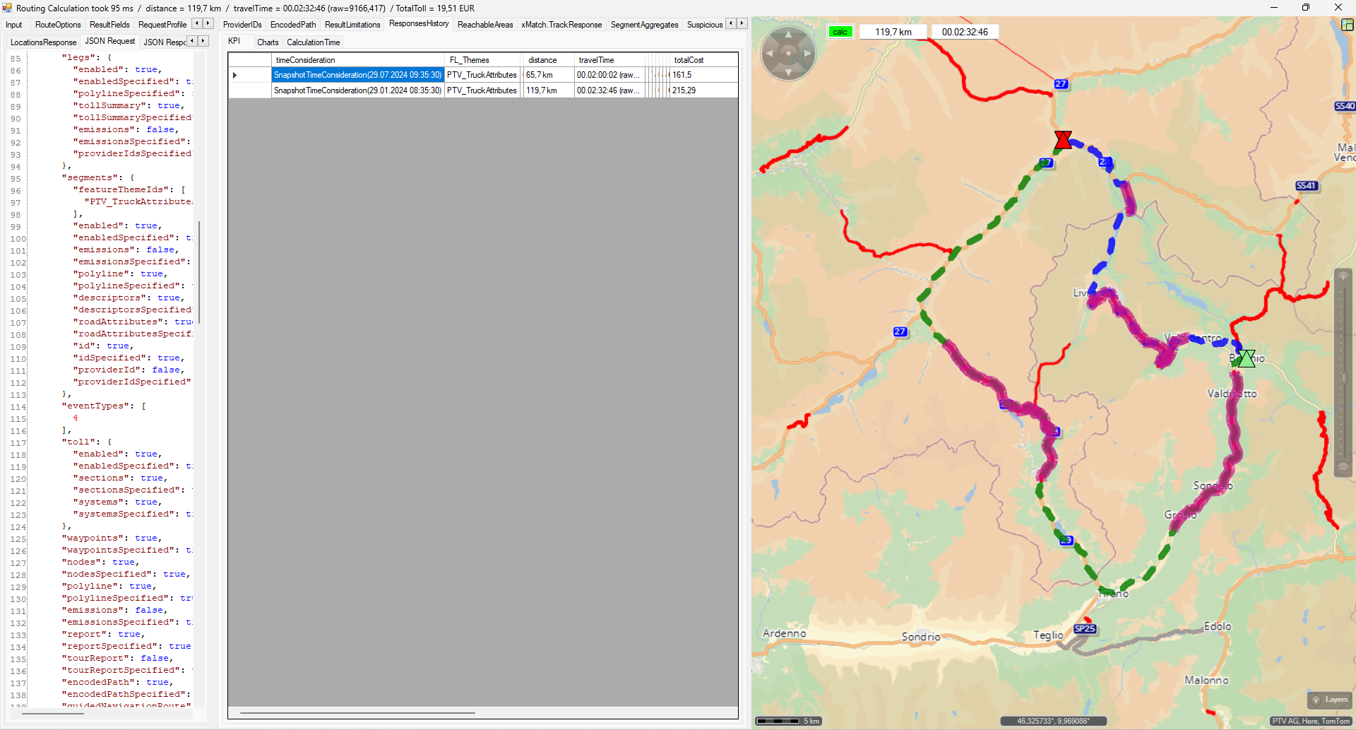

Re: How to block roads in winter (mountain passes)?
The routing from Bormio to Zernez. As there are time dependent PTV_TruckAttributes the time consideration has an impact on the geometry. I calculated the routes for 29.7.2024 and 29.01.2024 (windter - blocked)
