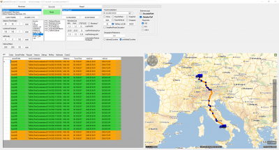

Mannheim to Neapel. Reference time changes
