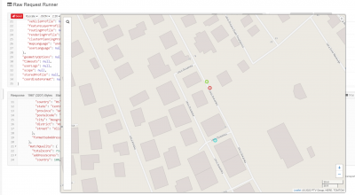

Hallo zusammen,
gibt es eine Möglichkeit, die Qualität des Ergebnisses des Geocoders über gewisse Parameter zu verbessern?
Wir haben einige Beispiele, bei denen die Qualität der Adresse eigentlich sehr gut ist, aber xLocate leider falsche Ergebnisse liefert.
Konkretes Beispiel:
countryCode: RS
city: BEOGRAD
postalCode: 11000
streetAndNumber: 26 DUKATSKA
... liefert ...
countryCode: RS
city: Mladenovac
postalCode: 11400
streetAndNumber: Ulica Dunavska 26
Falsche Postleitzahl, falsche Stadte, falsche Straße.
Ich vermute mal, dass es an "schlechtem" Kartenmaterial liegt, aber evt. gibt es doch eine Mölgichkeit per Parametrierbarkeit?
Vielen Dank!
Schöne Grüße,
Claus Vogelmann
Posts: 3094
Re: xLocate - Ergebnis verbessern

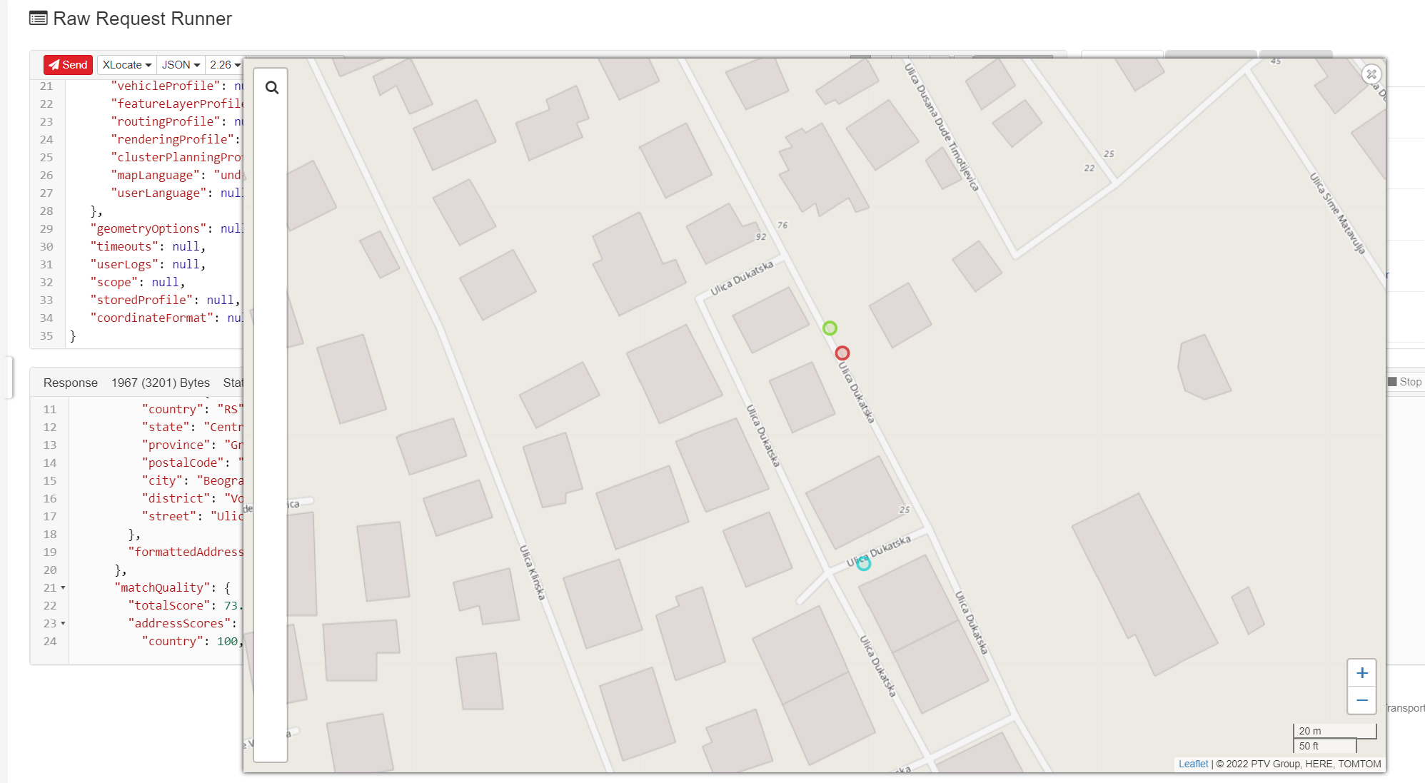

Hello Claus,
please be aware that the one and only language in the forum is english.

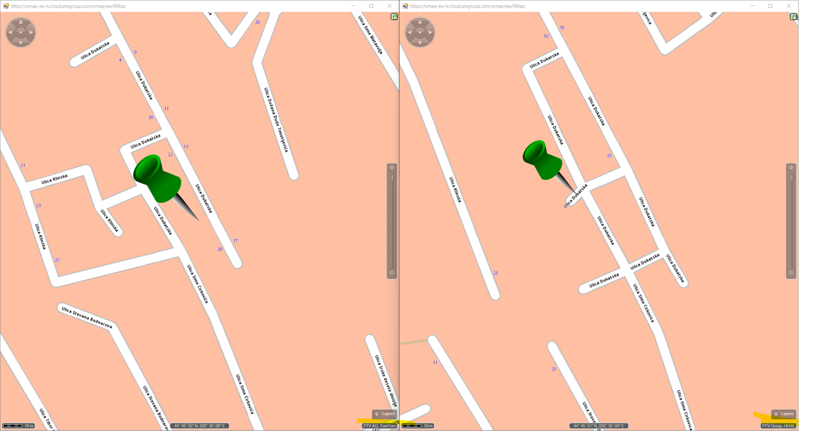

The XLocate 1 API offers various search options you can use to control the handling of the geocoding via findAddress. I used the default settings of the engine to perform a search for the sample address both on TOMTOM and HERE and in both cases I get proper hits:
left: TOMTOM map<br />right: HERE map
left: TOMTOM map
right: HERE map
The design of the xLocate2 tries to minimize the amount of potential parameters because these lead to too many discussions in the past. The API v2 tries to ensure that the desired address is at least part of the result. Users can then easily use the additional output properties to sort and filter the result list.
Maybe you can send your exact sample request to us and we can analyse what went wrong in this specific case?

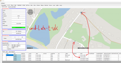

Use "mapLanguage":"und-Latn-t-sr" and you get the results in latin transcript... instead of cyrillic)

Posts: 3094
Hi Claus,
what version of the geocoding index do you use? I use the same one as XServer Internet (20220307)
When I preform your request on XSI2 the output shows a proper street level hit.
Not the house number itself (26 is missing - for whatever reason), but at least the street is found.
In your case the zip code 11000 seems to be wrong, too (proper value: 11050)
Let's check this in our 1:! session.
PS: new index is available on request for on premise users.

Just learned another code: "und-Latn-t-uk"... unfortunately the documentation of the codes is quite generic.
mapLanguage=&quot;und-Latn-t-uk&quot; returns the transcripted version of the ukrainian texts. Therefore the map looks equal to the texts below
mapLanguage="und-Latn-t-uk" returns the transcripted version of the ukrainian texts. Therefore the map looks equal to the texts below

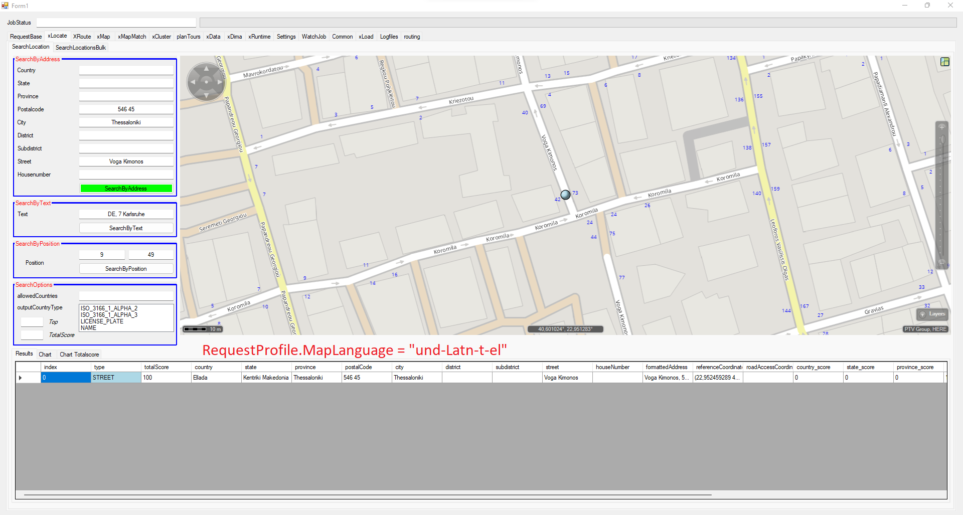

And here comes a GREEK example: Use MapLanguage="und-Latn-t-el" to get " Greek transliterated to latin alphabet (transformation subtag)."
