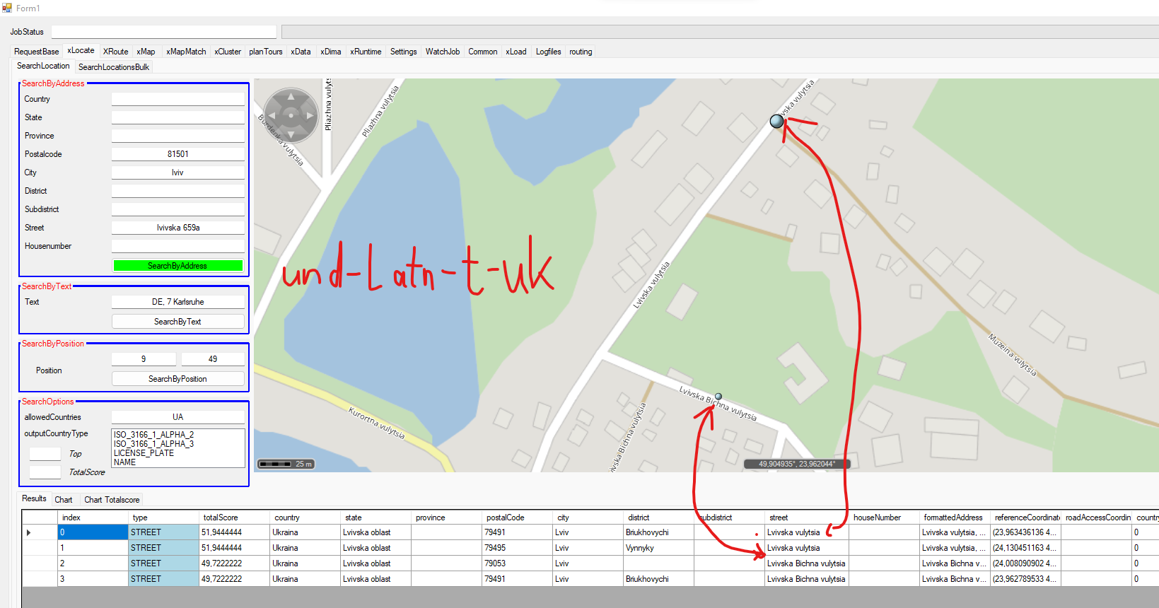

Just learned another code: "und-Latn-t-uk"... unfortunately the documentation of the codes is quite generic.
- Attachments
