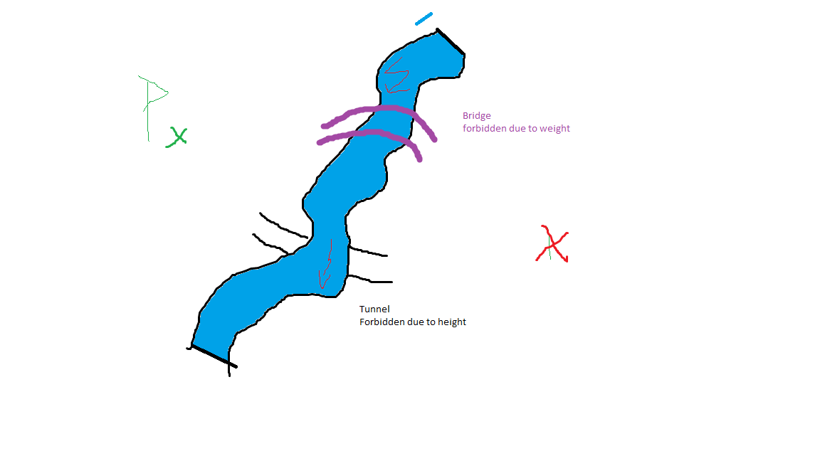

Imagine the following situation:
  • A river where you want to travel from one side to the other
  • There's a bridge and a tunnel
  • Your vehicle is to heavy for the bridge
  • Your vehicle is to tall for the tunnel
  • Algorithm returns with a "I can't route from start to destination"
Now what output would you expect?
