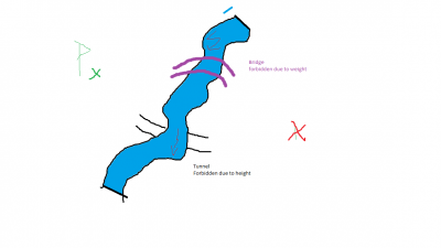

Now coming back to your question:
However for other cases, how can I make sure that the error comes from the fact that the possible routes necessarily have a point with ferry and not for another reason?
I think you can't. The maximum information you could get from the engine is "what leg is crucial?".
You can't get the info whether the ferry malus or the toll malus or a weight restriction is responsible for the error.
This is because there is not just one source (segment, ferry) to be blamed.
Imagine the following situation:
  • A river where you want to travel from one side to the other
  • There's a bridge and a tunnel
  • Your vehicle is to heavy for the bridge
  • Your vehicle is to tall for the tunnel
  • Algorithm returns with a "I can't route from start to destination"
Now what output would you expect?
