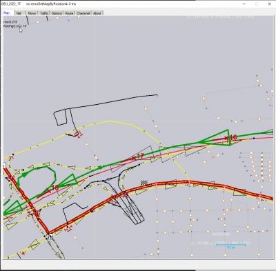

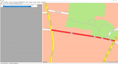

We've asked for route between:
Am Volkspark 9 50321 Brühl
Bergerstraße 50321 Bruhl
We've used the attached mg-truck-40t.xml profile.
On pic1.png you can see that there is a truck attribute on Königstrasse, called:
DIR_OPT_COND_MALUS5|0=75
According to this page: https://xtour-eu-n-test.cloud.ptvgroup. ... Format.htm
It means that:
"closed for vehicles heavier than a given weight except for residential vehicles"
It's on pic1:

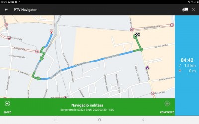

If we generate a BCR from this route, and open it in PTV Navigator, it knows this attribute, and reroute trough another way:
I've two questions:
- why doesn't recognise the xServer xRoute, that Königstrasse is closed for a 40T truck?
- how does exactly BCR with PTV Navigator works? Can we force the navigator to use the exact road we've planned in xS?
Thank you,
Peter

Re: xS1 vs PTV Navigator
Hello Peter,
I am sorry to bother you but: please provide the complete request, response and also the URL you used.
If you prefer me to handle this 1:1 send it via email.
Posts: 3040
One thing I just saw in your profile:
You enabled AdditionalDataRules - you specified the PTV_TruckATtributes but you did not mention the binary truck attributes layer (the one that contains the DIR_OPT_COND_MALUS5|0=75)
Your profile: <AdditionalDataRules enabled="true">
Correct: <AdditionalDataRules enabled="true" layerName="TruckAttributes">
Please ensure to use the same set of layers in the mapping and the routing context.
Maybe this already explains the case.

Posts: 318
A quick warning though:
The truck attributes feature layer are loaded in your vehicle profile. So atm you are using "RoadEditor" technology in xMap and "FeatureLayer" technology in xRoute. Although both data layers are using the same source data and should represent the same use case, the way some specific blockings are handled is different in both technologies.

innomedio
Posts: 33
Joined: Thu Sep 03, 2020 2:26 pm
Post by innomedio »
Hi Everyone!
Thank you for all the answers.
@Bernd:
This solved the problem!
I'd like to learn more about the layers. We've always thought that enabling a the AdditionalDataRules and including the <Theme id="PTV_TruckAttributes" enabled="true"/> is enough.
Is there a detailed documentation somewhere about using the layers/datarules?
@Joost:
I'm not sure I fully understand what you wrote. But I'm guessing it's connected to the one I just wrote to Bernd.

Posts: 318
@Joost:
It's connected to Themes vs DataRules?
When we started with our software we just took the cor map data from our provider and made our maps from it. As time passed our map providers collect more and different forms of data and they introduce a separate data set we are now calling Truck attributes. So we needed a technology to add this separate dataset to the map and the Road editor technology was created.
As time passed by more and more data became available and our RoadEditor technology was no longer good enough to deal with all of that so we created a new technology for adding data to a core map: FeatureLayer. It has several advantages of RoadEditor. To name some:
* It scale better so we can deal with larger data sets
* It is more flexible under the hood so it is easier for PTV to intro duce different kind of data
* it has support for time dependency on data
* multiple layers can be loaded in
A good example of this is our speed patterns layer for calculating realistic travel time based on historic traffic information. The data set is way to big for RoadEditor, we are not using blocking but speed and delay properties and data is time dependent.
To come back to the set this topic started with: Truck Attributes. For this particular use case Roadeditor mostly holds up as a good technology. Although it misses time dependency the data set is not so big that is doesn't fit and we have mostly all the properties we need. Since we had many customers use Roadeditor we kept making these layers since it was already part of our process chain and it save customers from extra work on switching while there is for them not that much of a benefit. So currently we see the road editor data as technically deprecated but we do still support customers using this. For our newer technology stacks like xServer 2 RoadEditor is not included. So right now our xServer 1 customers can make use of both technology, although we recommend using the feature layer technology.
Like i wrote before, the data is not exactly the same. For "simpel" blockings like for example "Max Heigth" it does work exactly the same. But for more complex blockings like "Max weight with exception for local acces" there is a difference. In Roadeditor there was not a good property for this but we did have some extra reserved properties for future use so we took one of those. That why the name is road editor (DIR_OPT_COND_MALUS5) is not self explanatory and you have to check the documentation to know exactly what this is. For feature layer this is different so we can simply make it a blocking with a max weigth and a delivery exception.
With this all there is also a difference in configuration of the vehicle profile. Feature layers are loaded via the Profile
/FeatureLayer / Themes[] , road editor is load via the Profile / Routing / Course / AdditionalDataRules / @layerName . The finer details of the blocking in question is configured via a Profile / Routing / Course / AdditionalDataRules / Legacy / KeyValue setting, where the feature layer just looks at the more general settings. Note: normally you do not need to configure the finer settings, that is only needed in exceptional cases.
In your original question you uses a screen where xMap is using RoadEditor technology and you referred to the documentation that deals with RoadEditor technology in xRoute. So Bernd answer "load in the RoadEditor technology layer" makes sense. My point is that in that case you should disable the feature layer (remove the truck attributes them from your profile) . Using to technologies for the same can can sometime lead to unforeseen issues when configurations contradict.
There is one thing remaining: your original question "why doesn't recognise the xServer xRoute, that Königstrasse is closed for a 40T truck?" , after spending a bit more time then I car to admit i found the answer: The blocking is directional, as in only valid for one direction. So xRoute simply take the the road in the the direction the blocking is not valid for.
Posts: 3040
Hi Joost,
thanks for the detailed response! Let me add some small remarks - just to round up the picture:
  • Legacy versus FeatureLayer: the FeatureLayer concept was defined to replace different old approaches:
    • Historical information aka "Ganglinien" was replaced by FL PTV_SpeedPatterns and PTV_TruckSpeedPatterns
    • Live Traffic aka "Traffic Info Loader" was replaced by PTV_TrafficIncidents (in combination with Content Update Service)
    • Legal restrictions aka "TruckAttributes" (binary Road Editor Layers) have been replaced by PTV_TruckAttributes
    We did this to get rid of the old technologies which have sometimes caused troubles / interferences when users tried to combine them in single requests.
  • Time dependency: One big benefit of FL technology is the availability of time dependent information. This enables us to define blockings such as the traffic incidents. And this also comes into usage for time dependent truck attributes such as "blocked for trucks during the night". An old school binary truck attribute just stored the attribute but not the validity period. So for some segments which have time dependency in real life our data team was forced to decide between YES (but then it appeared in the binary data as a static blocking) and NO (then it didn't appear in the binary data). So with this time dependency properties in the feature layers we closed an important gap.

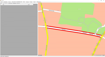

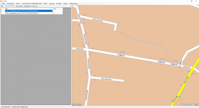

  • Direction dependency: As Joost mentioned: some blockings could have a restriction which applies in a single direction. For that we need a closer look at the attribute: DIR_OPT_COND_MALUS5|2=75 means that the weight restriction refers to a specific direction
    • 0 - in reverse storage direction (aka opposite direction)
    • 1 - in storage direction (aka deposite direction)
    • 2 - there is no information about the direction
    Important: in the context of "visualizing the built in attributes" there's no driving direction - therefore the statement refers to "how the data is stored in the database (storage direction)". As users usually don't have information about the storage direction I guess the relevance of the attribute turns to "both directions" versus "single direction" without knowing which one.
Oldschool binary TruckAttributes on current TOMTOM map (XSI)
FeatureLayer PTV_TruckAttributes on current TOMTOM map (XSI)
