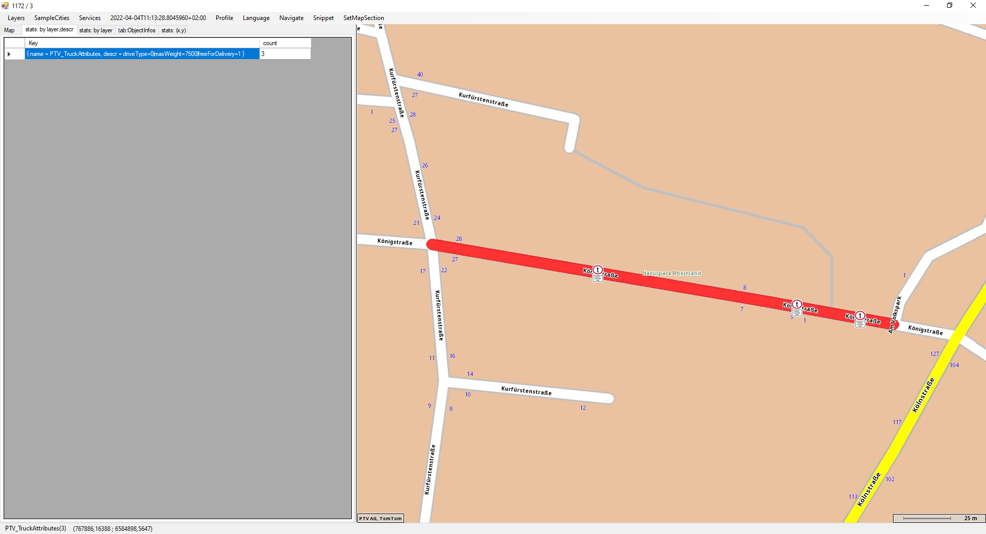

We've asked for route between:
Am Volkspark 9 50321 Brühl
Bergerstraße 50321 Bruhl
We've used the attached mg-truck-40t.xml profile.
On pic1.png you can see that there is a truck attribute on Königstrasse, called:
DIR_OPT_COND_MALUS5|0=75
According to this page: https://xtour-eu-n-test.cloud.ptvgroup. ... Format.htm
It means that:
"closed for vehicles heavier than a given weight except for residential vehicles"

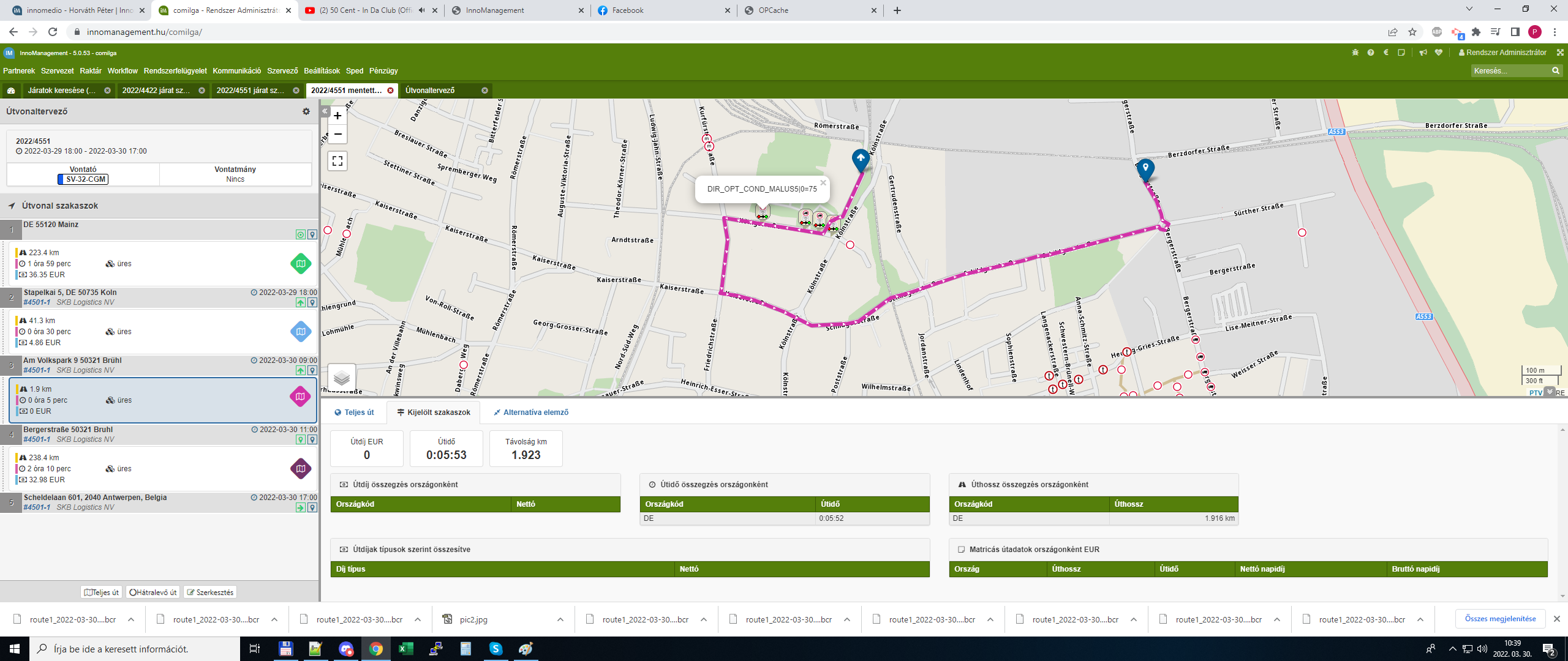

It's on pic1: If we generate a BCR from this route, and open it in PTV Navigator, it knows this attribute, and reroute trough another way: I've two questions:
- why doesn't recognise the xServer xRoute, that Königstrasse is closed for a 40T truck?
- how does exactly BCR with PTV Navigator works? Can we force the navigator to use the exact road we've planned in xS?

Hello Peter,
I am sorry to bother you but: please provide the complete request, response and also the URL you used.
If you prefer me to handle this 1:1 send it via email.
- Posts: 3010
Re: xS1 vs PTV Navigator

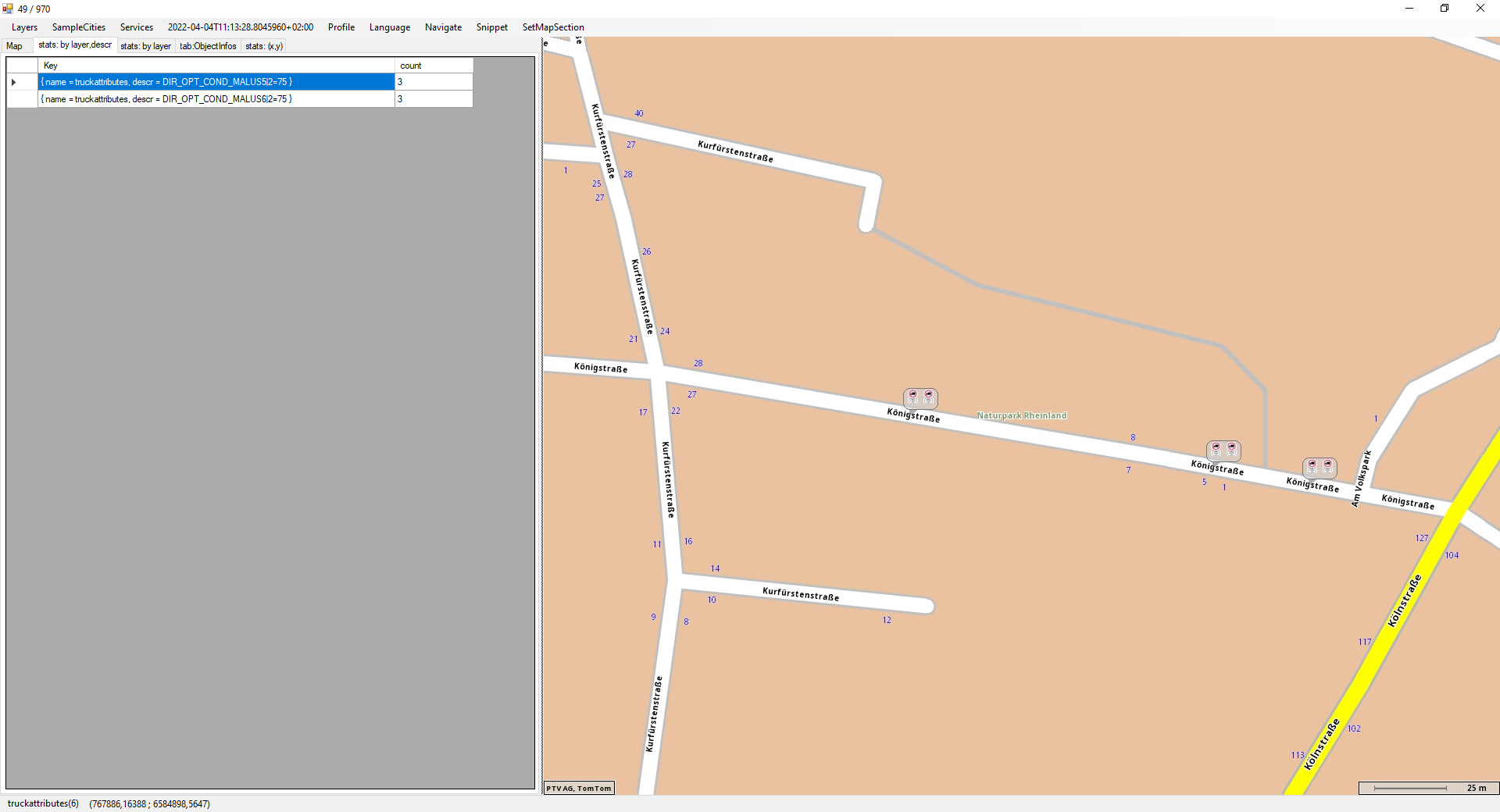

One thing I just saw in your profile:
You enabled AdditionalDataRules - you specified the PTV_TruckATtributes but you did not mention the binary truck attributes layer (the one that contains the DIR_OPT_COND_MALUS5|0=75)
Your profile: <AdditionalDataRules enabled="true">
Correct: <AdditionalDataRules enabled="true" layerName="TruckAttributes">
Please ensure to use the same set of layers in the mapping and the routing context.
Maybe this already explains the case.
About the Navigator question: is it possible to force a navigation to use the route created by xServer?
This topic is called "guided navigation" and requires you to create a BCR file. The process is desribed in https://xserver.ptvgroup.com/forum/view ... f=49&t=449 but we would need Sebastian to handle this. Afaik there's no guarantee that such a process does never leave the precomputed track. It simply makes the segments of that track cheaper but once the driver has left the "gravity" of the core route it can happen that the navigator recomputes the track.

The truck attributes feature layer are loaded in your vehicle profile. So atm you are using "RoadEditor" technology in xMap and "FeatureLayer" technology in xRoute. Although both data layers are using the same source data and should represent the same use case, the way some specific blockings are handled is different in both technologies.
I would highly recommend you stick to a single technology choise in both xServers.

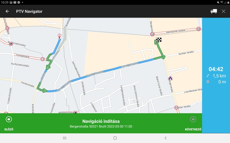

from Navigator side you have two options:
Enabling forgettweakloryrestricions and setting this tu true. This will ignore soft restrictions in the Navigator map and trying to follow the route the best way it is provided in the BCR. For more details please have a look in the attached PDF.
The second option is to provide a car profile in the BCR that only is considered for the BCR.
apart from that I've attached a document that gives more insights about GuidedNavigation.
BR
Sebastian Schlichting

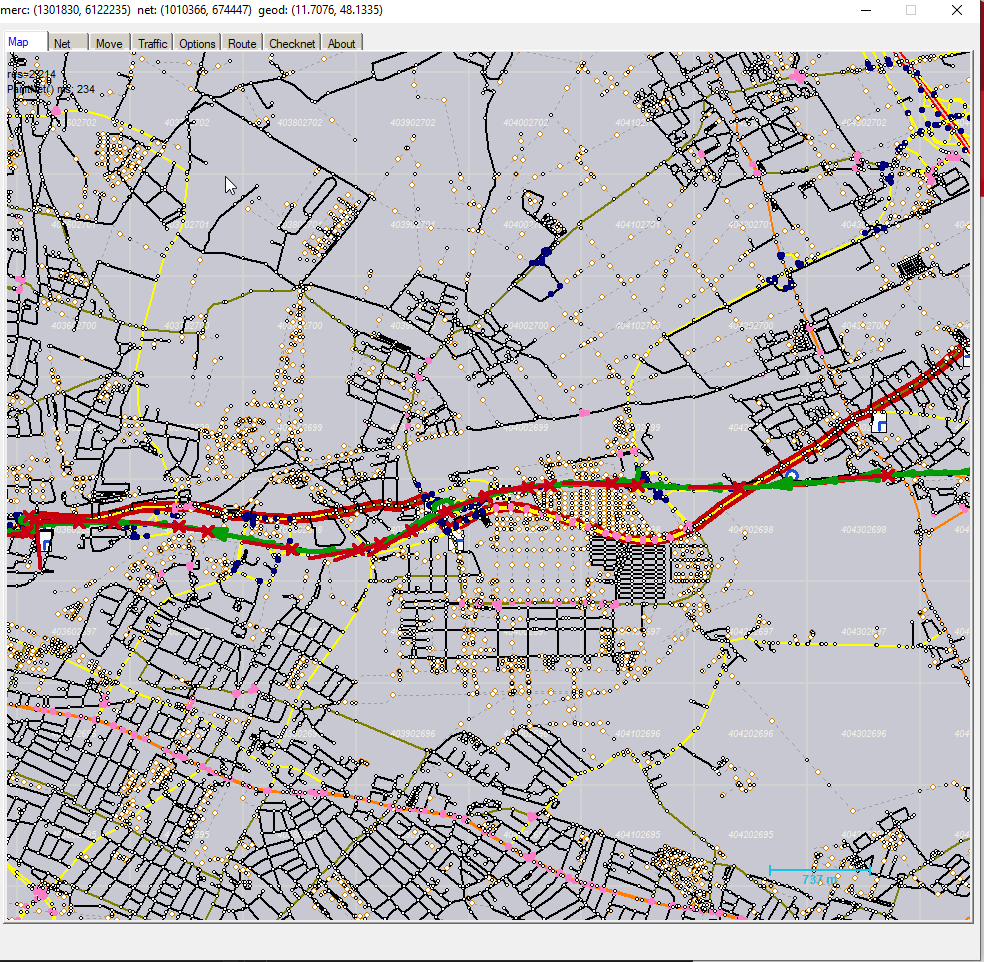

The tool Tilerouting can be found here:
https://ptv2box.ptvgroup.com/index.php/ ... McdX66TSsX
(the PW is your mail address)
In the first step, please set the path for the map in the ini file.
The map data you can obtain from the android device. Please copy all map data that you find on the mobile device in the app folder /files/downloads/ that start with map_* into one folder on your computer. you need to extract all single files into one folder!
Tilerouting is an internal tool, so we can not provide support for that.
How to open a bcr file: right click "load bcr file". select the stations to visualize and tap z to zoom to the opened bcr file. you will see them as a red x with ---- that shows the heading of the mvps.
