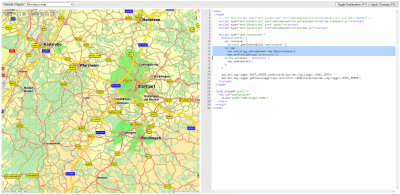

this week a partner asked me weether it is possible to apply a custom profile in AJAX maps (xMap 1). He wanted to display EMISSION ZONES on a map. Well, here's the result and below you can find the instructions:
sample - ready to be executeed in the AJAX tutorial

  • a set of ajax profiles ("bg", "fg", "ov"):
    xmap-greenzones-ov.properties
    overlay
    (6.43 KiB) Downloaded 6343 times
    xmap-greenzones-fg.properties
    foreground
    (6.48 KiB) Downloaded 6336 times
    xmap-greenzones-bg.properties
    background
    (6.48 KiB) Downloaded 6149 times
  • propagate the profiles in the ajaxmaps.properties as a new "group" - they define a so-called ProfileGroup:
    xmap.profile.foreground.greenzones = greenzones-fg
    xmap.profile.background.greenzones = greenzones-bg
    xmap.profile.overview.greenzones = greenzones-ov
  • Request the profile group in the ajax maps call:
    <html>
      <head>
        <!--[if IE]><script type="text/javascript" src="webcomponent/script/excanvas.js"></script><![endif]-->
        <script type="text/javascript" src="webcomponent/script/qooxdoo/script/qx-transport.js"></script>
        <script type="text/javascript" src=".qxrpc"></script>
        <script type="text/javascript" src="webcomponent/script/map.js"></script>
        <script type="text/javascript">
          function init() {
            var container =
              document.getElementById("mapContainer");
            var map =
              new com.ptvag.webcomponent.map.Map(container);
              map.setProfileGroup("greenzones");
            window.onresize = function() {
              map.updateSize();
          qxp.dev.log.Logger.ROOT_LOGGER.setMinLevel(qxp.dev.log.Logger.LEVEL_INFO);
          qxp.dev.log.Logger.getClassLogger(qxp.core.Init).setMinLevel(qxp.dev.log.Logger.LEVEL_ERROR);
        </script>
      </head>
      <body onload="init()">
        <div id="mapContainer"
          style="width:100%;height:100%">
        </div>
      </body>
    </html>

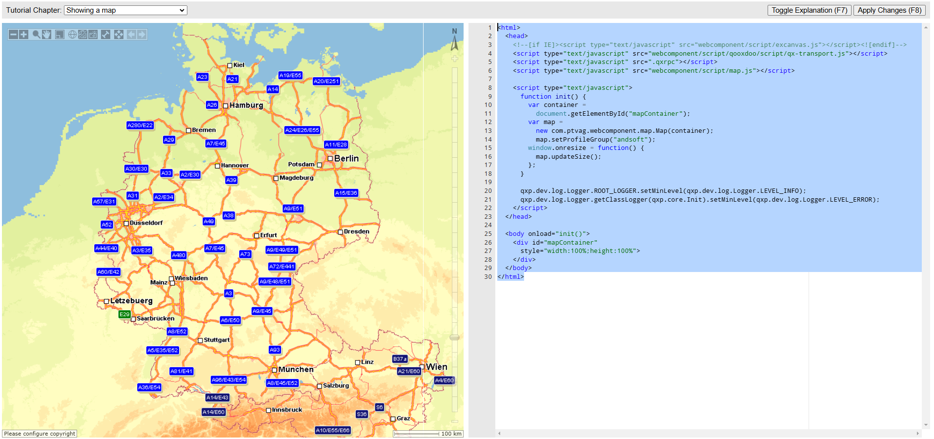

Customer asked "how to render highway signs already from a higher scale?"
Required keys:
[config.signthreshold]
0=0.000000
;Defaults
;1=100.000000
;2=100.000000
;updated values
1=500.000000
2=500.000000
