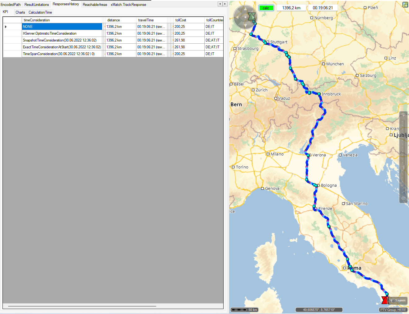

Sample route from DE-Mannheim to IT-Napoli (no feature layers activated)<br />Three times the same driving time and distance, but different toll prices. This is because of the different TimeConsiderationModes I applied.<br /><br />As NONE, OPTIMISTIC and TIMESPAN do not consider the daytime dependent toll in Austria the prices are lower than with ExactAtStart/ExactAtArrival and Snapshot.
