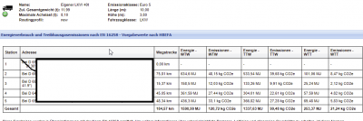

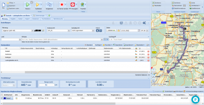

Screenshot from MGI
Screenshot from MGI
Screenshot from MGI
Screenshot from MGI

Result displayed in MGI
