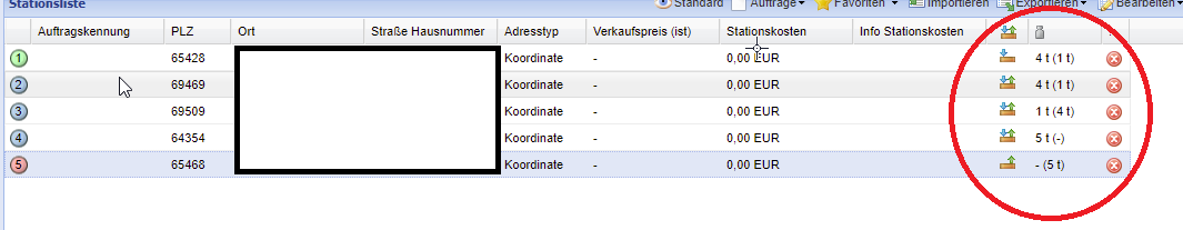

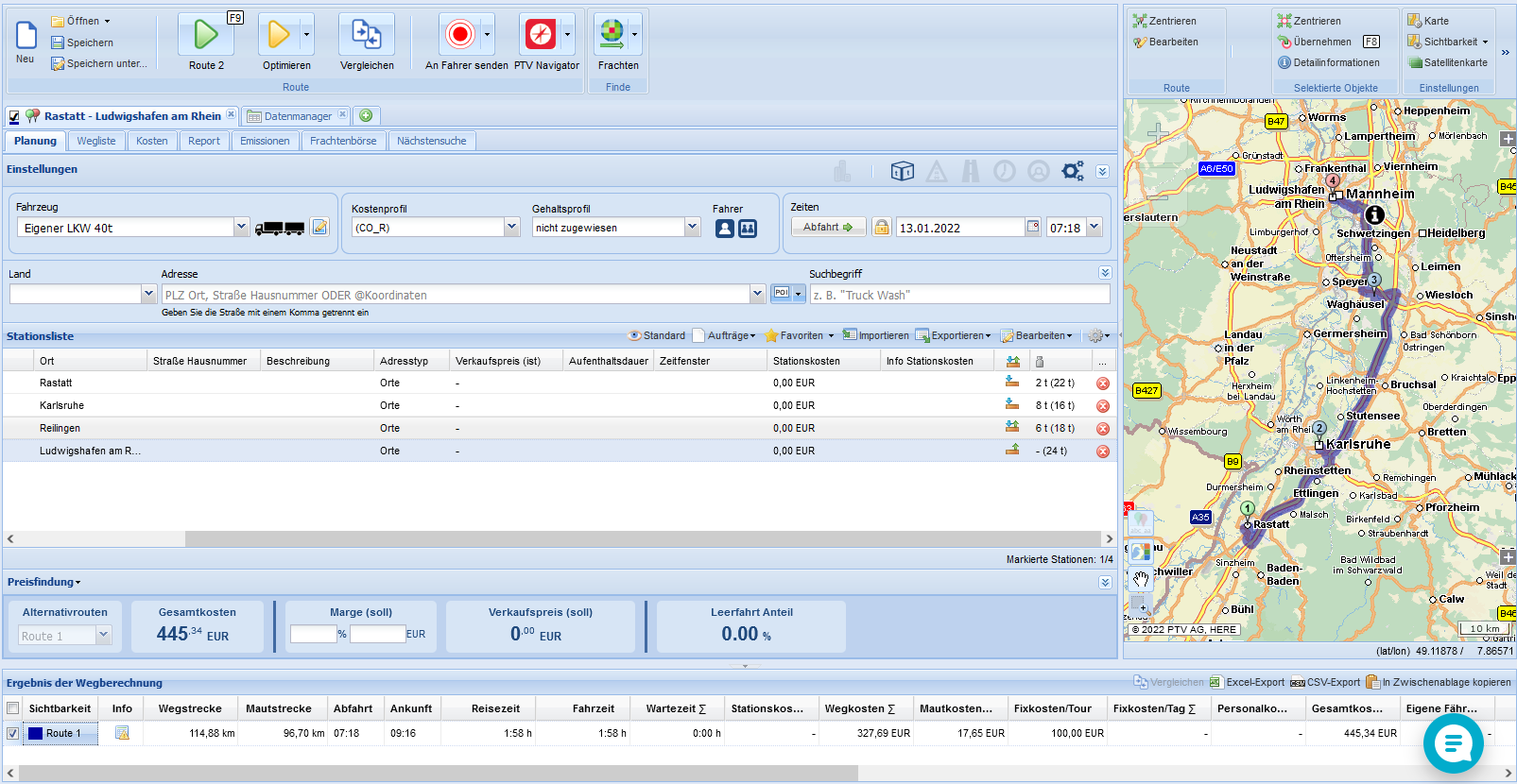

Screenshot from MGI
Screenshot from MGI
Screenshot from MGI
Screenshot from MGI

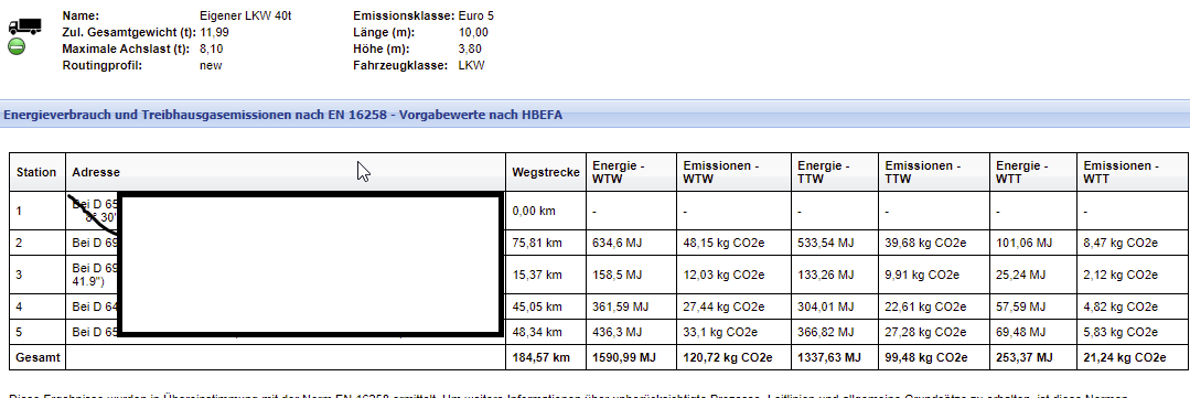

Result displayed in MGI
