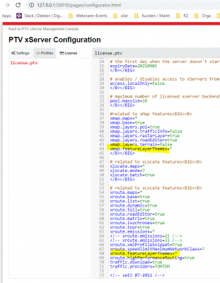

If you want to check the licensed feature layers I recommend to look into the license file manually (through the admin console)
My xserver 1 license grants acces to all installed feature layers due to the wildcard

OK based on your suggestion I decided to do a simple GET request to "http://xMapServer:port/pages/serverCommand.jsp?readLicense=license.ptv", read all the content and find out the license status that way.

Browser Dev Console(F12)/Network
There you can see the requests made to the webinterface
