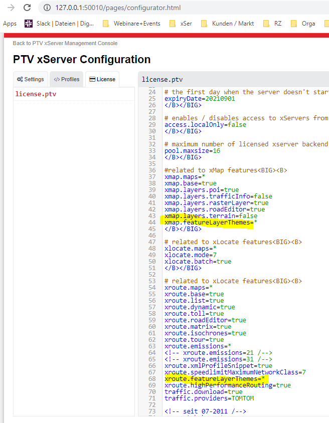

If you want to check the licensed feature layers I recommend to look into the license file manually (through the admin console)

OK based on your suggestion I decided to do a simple GET request to "http://xMapServer:port/pages/serverCommand.jsp?readLicense=license.ptv", read all the content and find out the license status that way.
My Ui is now switching automatically between showing traffic and not showing traffic.

That works, but keep in mind that it is not an official feature, so in later versions the page might work differently. I don't expect us to make changes in the xServer 1 management console now that we have xServer 2, but it could be.

Browser Dev Console(F12)/Network
There you can see the requests made to the webinterface
