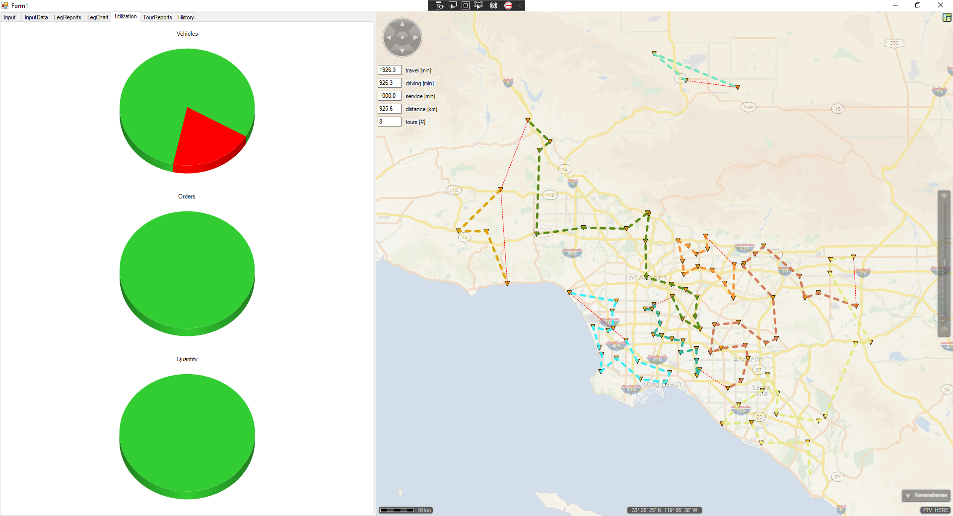

And here are some results - depending on some settings that are parametrized through the test client:
Long story short: from scratch each order can be handeled by each vehicle and from each depot.
Usually the number of tours is supposed to be minimized, even if this leads to additional distance contributions. By comparing the KPIs with the other results you can recognize the impact of that scenario. Here we produce a total distance of 1100 km which are based on 5 different tours (which means we utilize only 50% of the trucks). Keeping the number of tours as small as possible is a quite usual case.
With this setting the target function is now to minimize the KPIs such as distance and travel period. By utilizing 8 instead of 5 vehicles the overall distance is reduced from 1100km to just 925 km.
