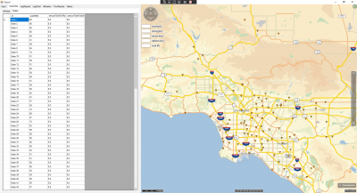

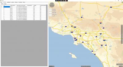

Here's the setup:
The story takes place on a single day planning horizon. I also deal with quantities and some constraints such as maximum driving time but there are no explizit time windows given. Skills/equipment aren't used in this example but they are available through the API.

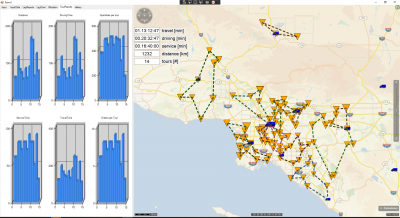

And here are some results - depending on some settings that are parametrized through the test client:
Long story short: from scratch each order can be handeled by each vehicle and from each depot.
In both of the samples above the tours ended at the last customer (determined by the engine). The user story is also based on "at the end of the day a vehicle should join the nearest depot whih is not necessarily it's start depot". I simply determined the "closest final destination" based on airline. Attention: this is business logic and not part of the optimum!

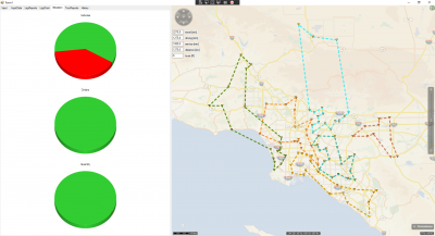

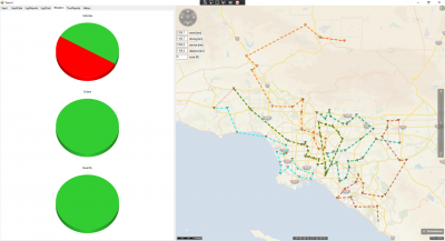

Now the next screenshots deal with closed tours (rountrips):

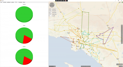

Update : here's also a sample where the number of vehicles per depot varies:
Most orders are handeled by the large depot in the center
