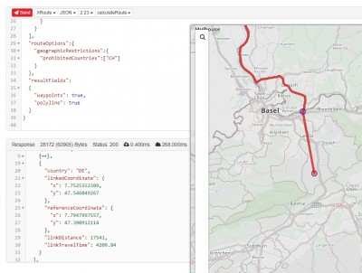

A screenshot of a small example:
Here you see I have a waypoint in CH and the engine will link to directly to the nearest road which is in DE.
I'm not sure what can be done to solve your use case. The way the engine prohibits countries cannot be changed since we need it for high performance routing to keep map data limited in a single network. As for way to work around this: i don't know your use case, i would recommend you would discuss this 1:1 with your primary xServer consultant.

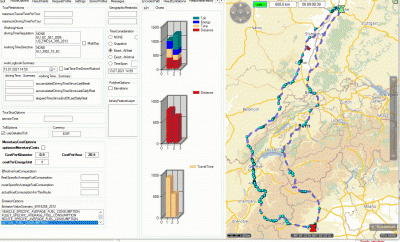

Brilliant. Here's also an example for the difference between cost optimized routing and the old school abstract routing.
Left chart series / western route: via France - more distance but less overall costs<br />Right chart series / eastern route: via Switzerland - short distance and shorter driving period but in total more expensive due to the toll costs
Maybe monetary cost optimized routing is also important to consider ;-)
