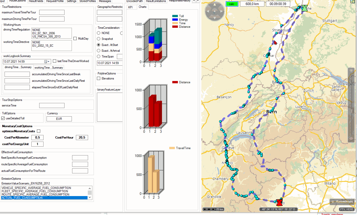

Brilliant. Here's also an example for the difference between cost optimized routing and the old school abstract routing.
Maybe monetary cost optimized routing is also important to consider
