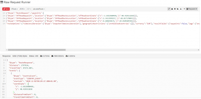

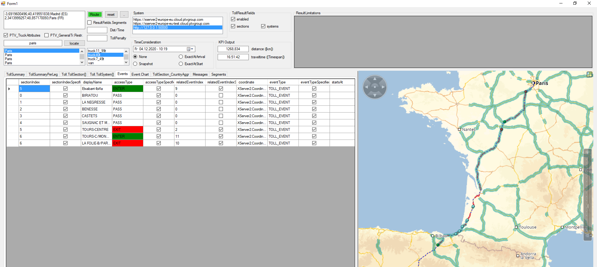

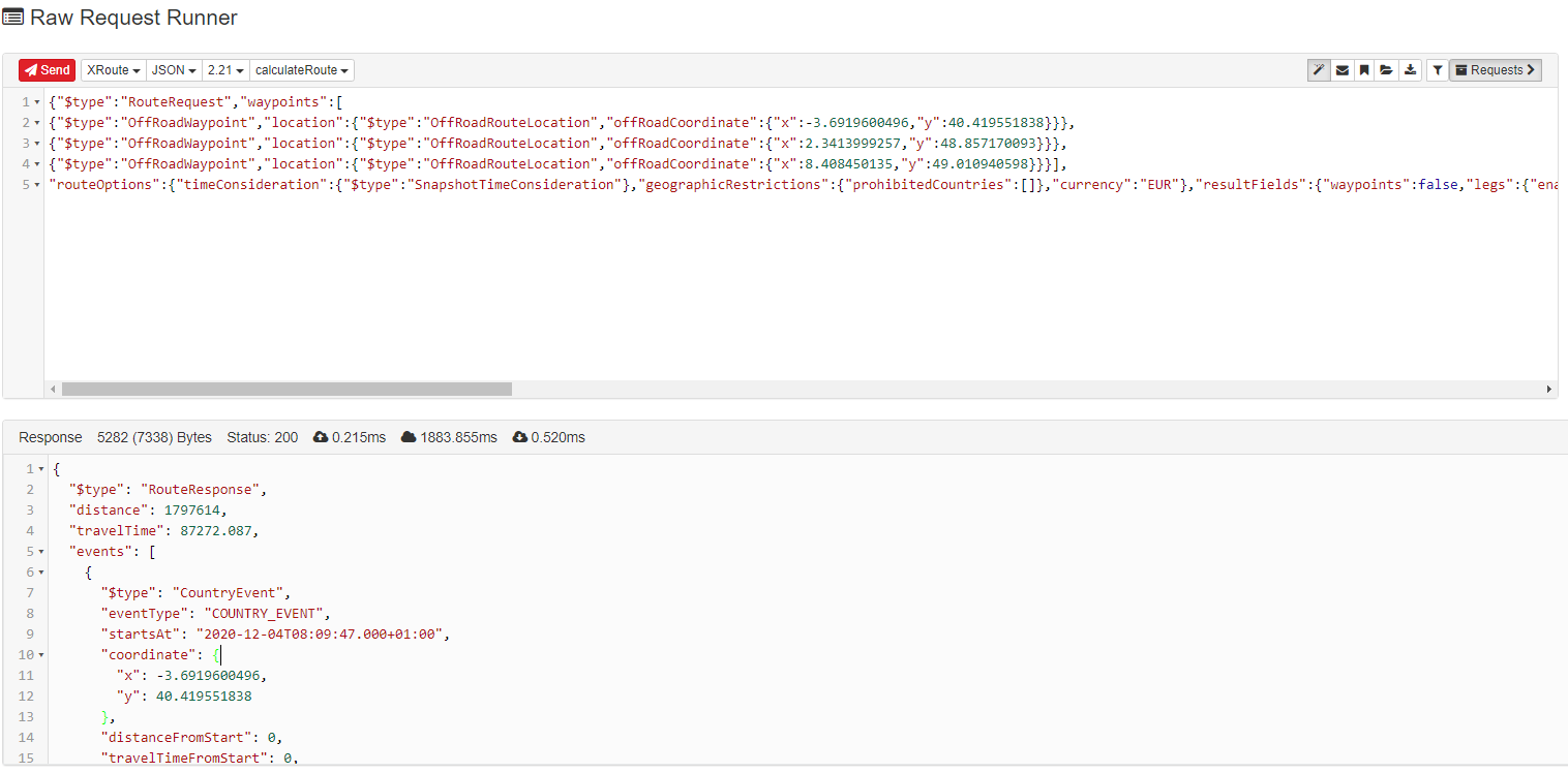

I calculated inofficial toll distances for countries which do not provide any official toll distances according to https://xserver.ptvgroup.com/forum/view ... f=7&t=1328
However, when I use the following route:
Madrid -> Paris -> Karlsruhe
I get 1 Toll event ENTER in spain and the next Toll event EXIT is already in France. When I use the approach of the link above I have to calculate the difference between those two events but a part of it belongs to Spain and the other part belongs to France. How to deal with that?
Please see the request and the response and the attachements.
