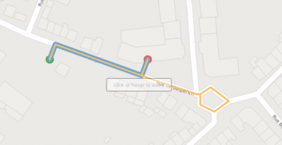

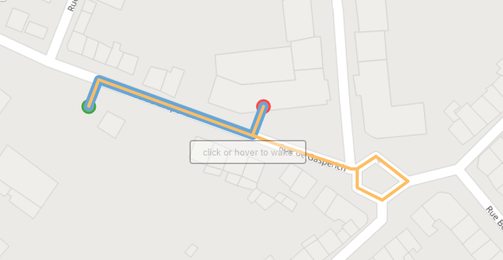

Screenshot taken from the integration samples. Route starts at GREEN and ends at RED. Depending on the property of the destination the route is direct (false) or performs a detour to approach the destination on the proper streetside.

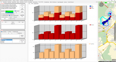

One usecase I'll check soon is the collection of garbage... ;-) works!
sequence optimization based on a DIMA that considers the driving side

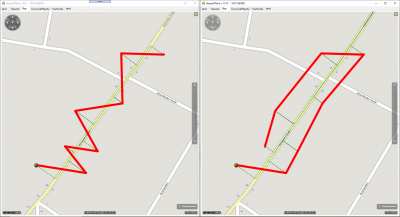

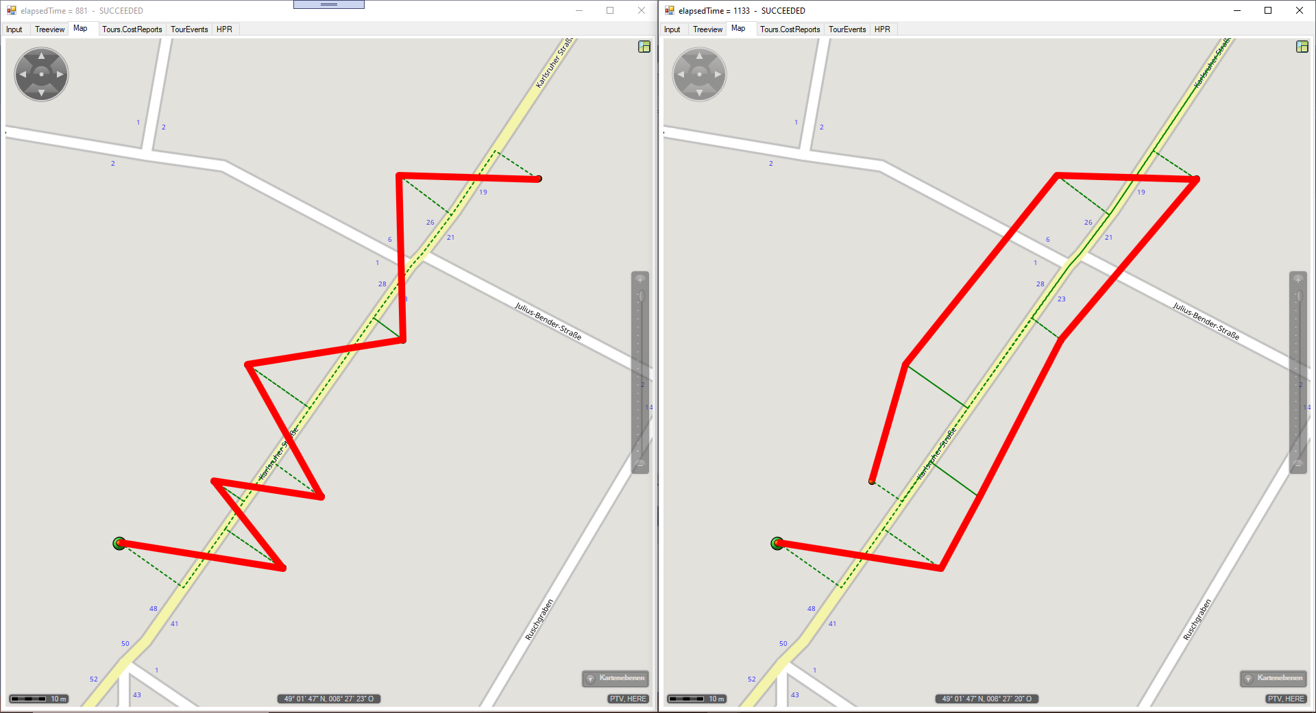

Wow - just played around with some inner city waypoints list...
The 8 routes seem to differ quite a lot:
I combined
