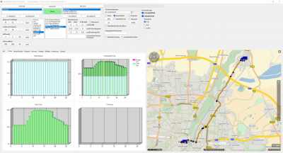

25 routings starting at 00:00, 01:00, 02:00... The first routing provided an encoded path object which is then used to enforce all succeeding routings to folow the same track. This is how a Multitraveltime distance matrix would create the information. All distances are equal, the worst traveltime is about 40minutes

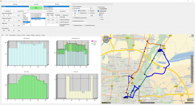

In this approach I did not reuse the encoded path. All 25 routings choose the optimal path depending on the time of the day. We encounter different geometries. And also the worst "traveltime" is about 33 minutes
