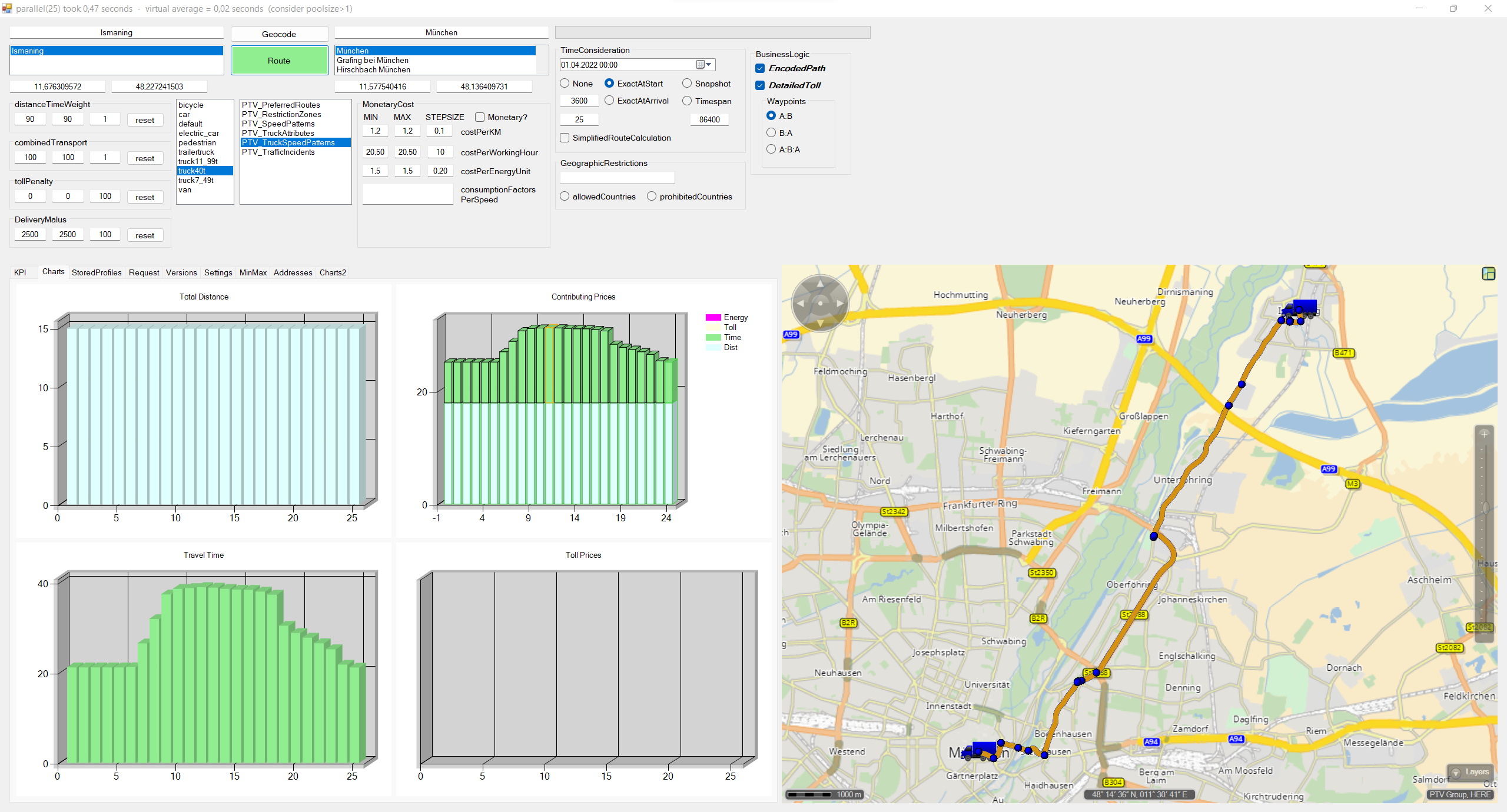

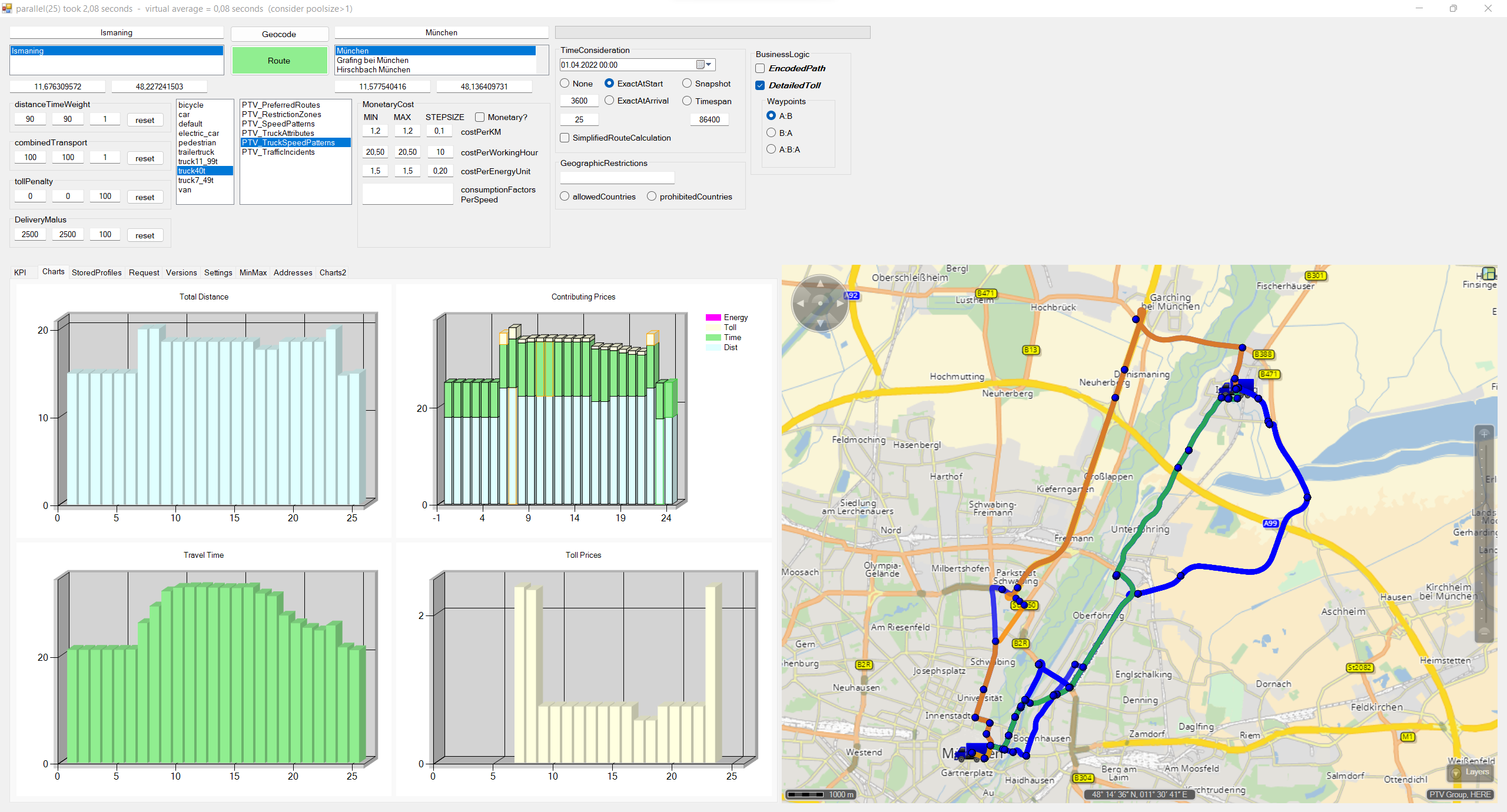

Short update: in v2.20 we invented a new time consideration mode:
Check com.ptvgroup.xserver.timeconsideration.MultipleTravelTimesConsideration
This mode (combined with any daytime dependent data such as PTV_TruckSpeedPatterns ...) enables you to create a distance matrix which stores not only a single value of distance and traveltime per relation:
It enables you to gather a stable distance(x1,y1,x2,y2) plus a variable traveltime (x1,y1,x2,y2,referencetime). In other words:
Please be aware the the geometry off the routes do not depend on the time of the day!
- We first compute the reference geometries of the routes.
- Then we apply the daytime dependency on the geometry based on the reference time
