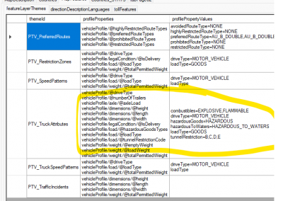

I also had this issue with using wrong property names.
I`m using xServer2 and there in the PTV_TruckAttributes properties list they`re named as 'combustibles', 'hazardousGoods', 'hazardousToWaters' and it`s only 3 of them as you can see.
But as seen in the post below 4 are noted: 'HAZARDOUS_TO_WATERS', 'HAZARDOUS', 'EXPLOSIVE', 'FLAMMABLE'.
Obviously the documentation is still not updated (seen by the names and number of properties), or maybe there is some other place there where they`re mentioned?
Marko
Marko

Ijust spoke to some DEV buddy - he recommends to keep the four potential values in mind:
Please geht back to me 1:1 for further discussion of what further info you need.
- HAZARDOUS_TO_WATERS
- HAZARDOUS
- EXPLOSIVE
- FLAMMABLE
