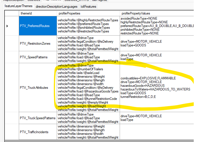

Re: xRoute1 vs. xRoute2: hazardousGoodsTypes
Ijust spoke to some DEV buddy - he recommends to keep the four potential values in mind:
  • HAZARDOUS_TO_WATERS
  • HAZARDOUS
  • EXPLOSIVE
  • FLAMMABLE
There's some built in mechanism in xRuntime2 which is supposed to assist in the automatic gathering of such properties and potential values. Unfortunately the method is experimental and not really dedicated to be used in public:
Output of the experimental method "xRuntime2.getDataInformation".
Please geht back to me 1:1 for further discussion of what further info you need.
