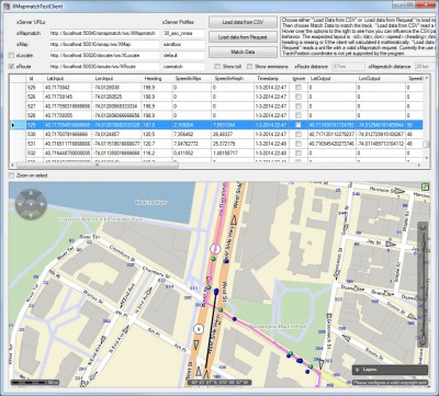

Map Legend:
Blue dot: input GPS point
Black line: heading of the selected input GPS point
Green dot: matched location, no speeding detected
Orange dot: matched location, little speeding detected
Red dot: matched location, speeding detected
Purple line: route reconstruction using xRoute
(not shown) blue line: route reconstruction using the path of xMapmatch
Screenshots:

Map Legend:
Screenshots:

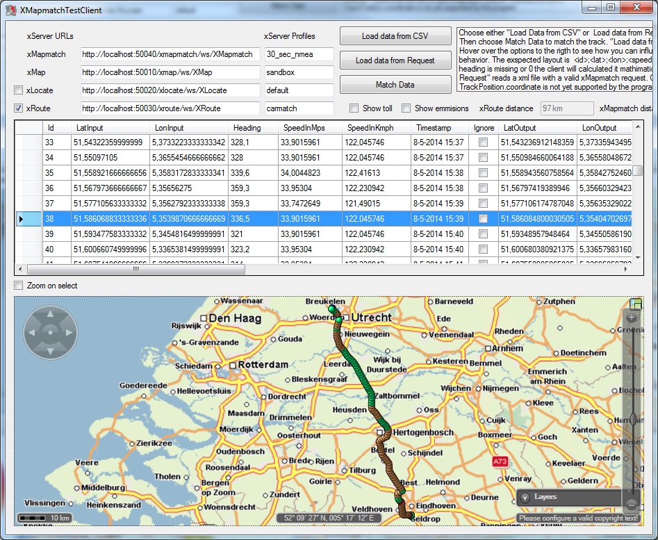

I added a new function to the test client: "Route sanity check". This function is useful if you want to send xMapmatch results to xRoute and you signal as such a high interval that you cannot use HistoryConsideration (aka global matching). if you do not have HistoryConsideration the chances of xMapmatch picking the wrong result will increase. "Route sanity check" will evaluate the map match result and only send points it is fairly certain of that they are OK to xRoute for a route calculation.

I updated the client. When you check "Make own timestamp" it will now calculate the timestamp based on the airline distance and average speed between 2 points. This now also works if you load data from a request instead of only if you load data from a CSV.

I made an update to the client.
BugFix: grid no longer remains empty when xMapmatch has found 0 matches or encountered an exception
New feature: added export button to export the data in the grid to CSV.
New feature: if the selected record in the grid has a matchedloctation, the segment which contains the match in the map wil be highlighted in red
Improvement: Route sanity check is now by default off. This post processing step is only useful if you do local matching. With the addition of AStar optimization to the crawler you should be able to use global mode now also for sparse track.
