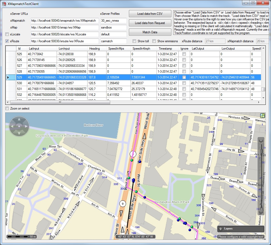

I'll use this thread to inform people about my test client. leave your feedback in the thread and then I can see If I can incoprorate it into the client.
Map Legend:
Blue dot: input GPS point
Black line: heading of the selected input GPS point
Green dot: matched location, no speeding detected
Orange dot: matched location, little speeding detected
Red dot: matched location, speeding detected
Purple line: route reconstruction using xRoute
(not shown) blue line: route reconstruction using the path of xMapmatch
