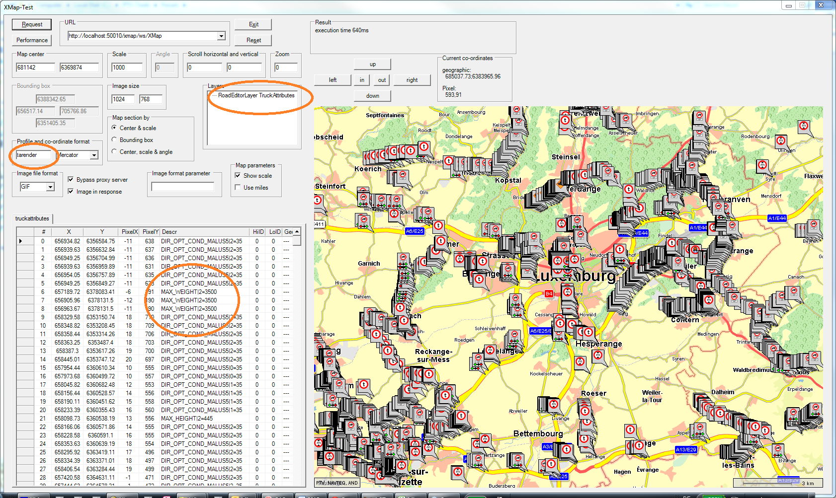

Hello together,
from time to time I'm getting asked about the number of TruckAttributes we provide with our data.
I'm using a dedicated mapping profile that visualizes the existing attributes on a level that is not meaningful for production but that is very helpful for debugging.
Maybe this profile can help you as well.
Just extract the archive into the /conf of xMap and request the profile via CallerContext:
<CallerContext_6>
   <CallerContextProperty key="Profile" value="tarender" />
   <CallerContextProperty />
 </wrappedProperties>
</CallerContext_6>
The result looks like this:
Output of request via xMap-Test tool
PS: the trick is the MaximumScale= value that is available for a large number of attributes. You may assign it to even higher values if necessary (with impact on performance but that's ok for debugging)
