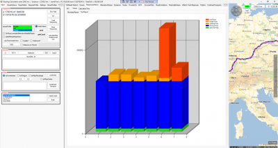

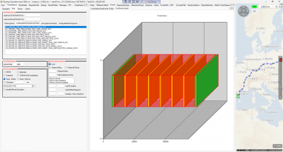

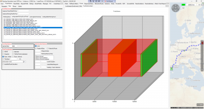

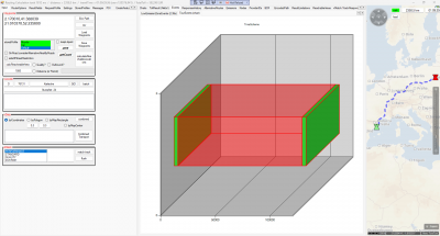

Just for the record: here's a selection of some of the com.ptvgroup.xserver.tourplanning.ConfigurableWorkingHoursPreset : The route goes from Barcelona to Wasrzaw. Service period at start and end = 3600secs.

As you can see: some of the presets cause VIOLATIONS on the tour because of exceedance of drivers "single day" working period. |
| The most important KPIs of the scenarios in comparison |
| As you can see in this overview some of the routes are violating the tour constraints. |
