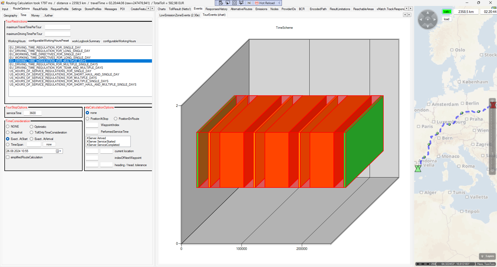

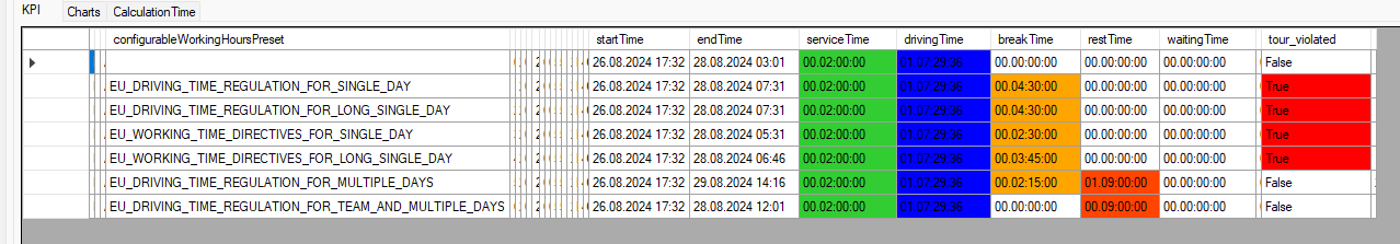

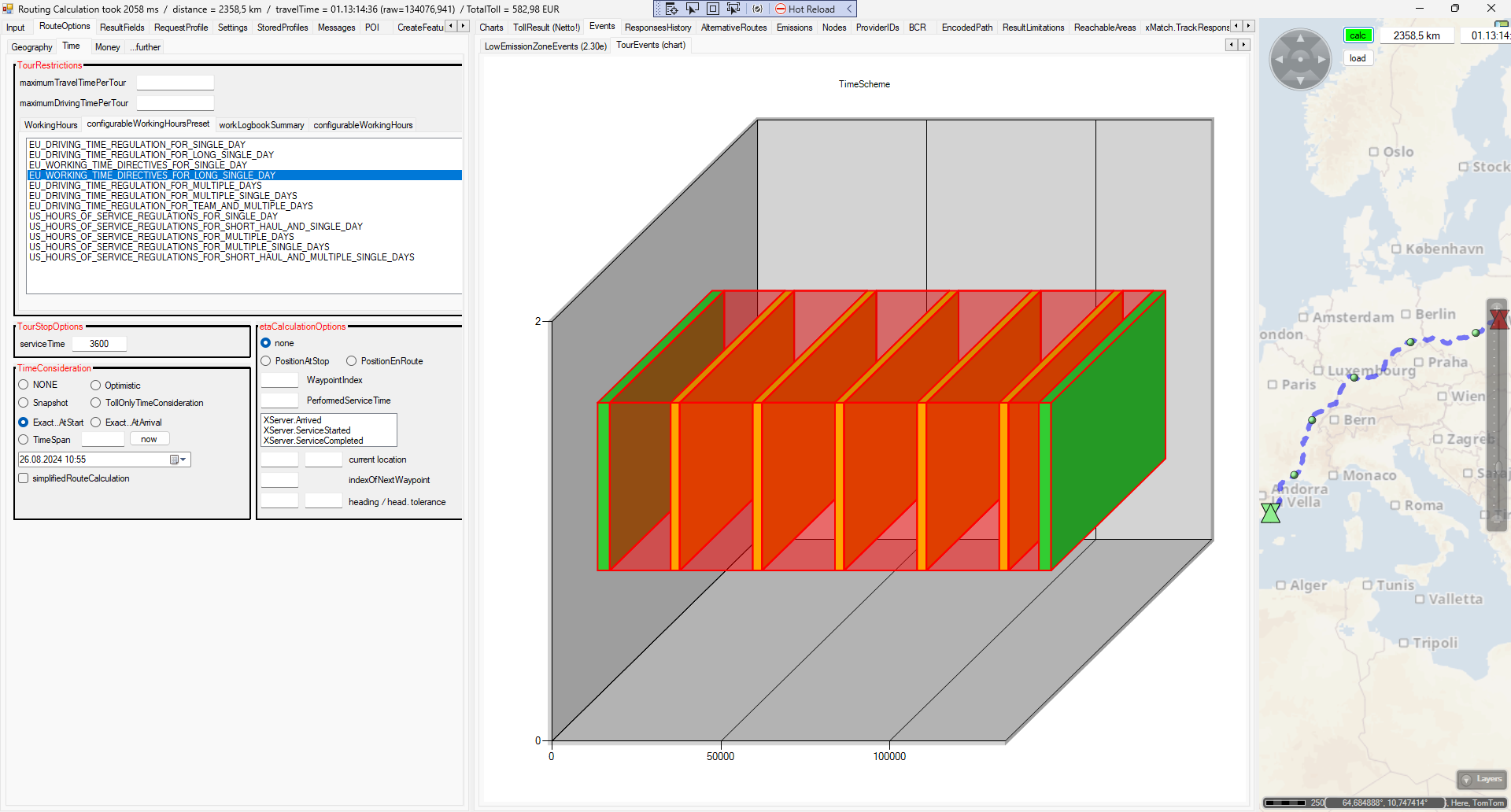

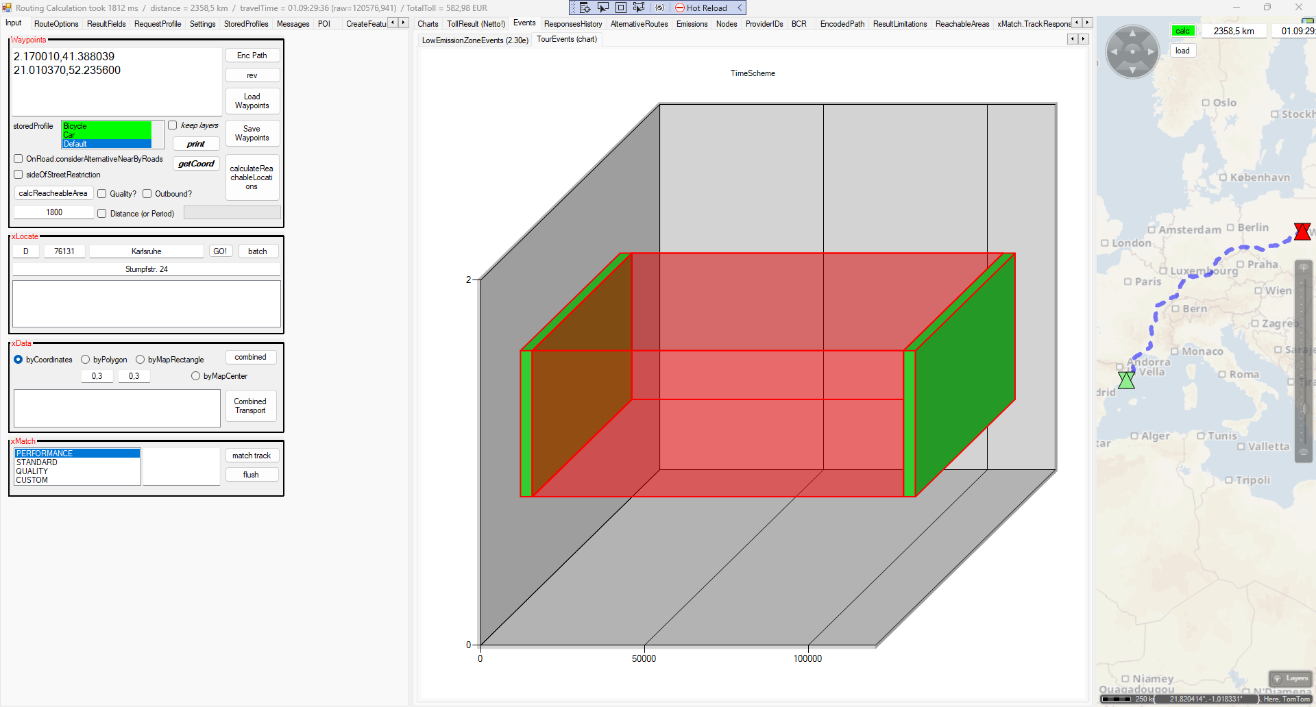

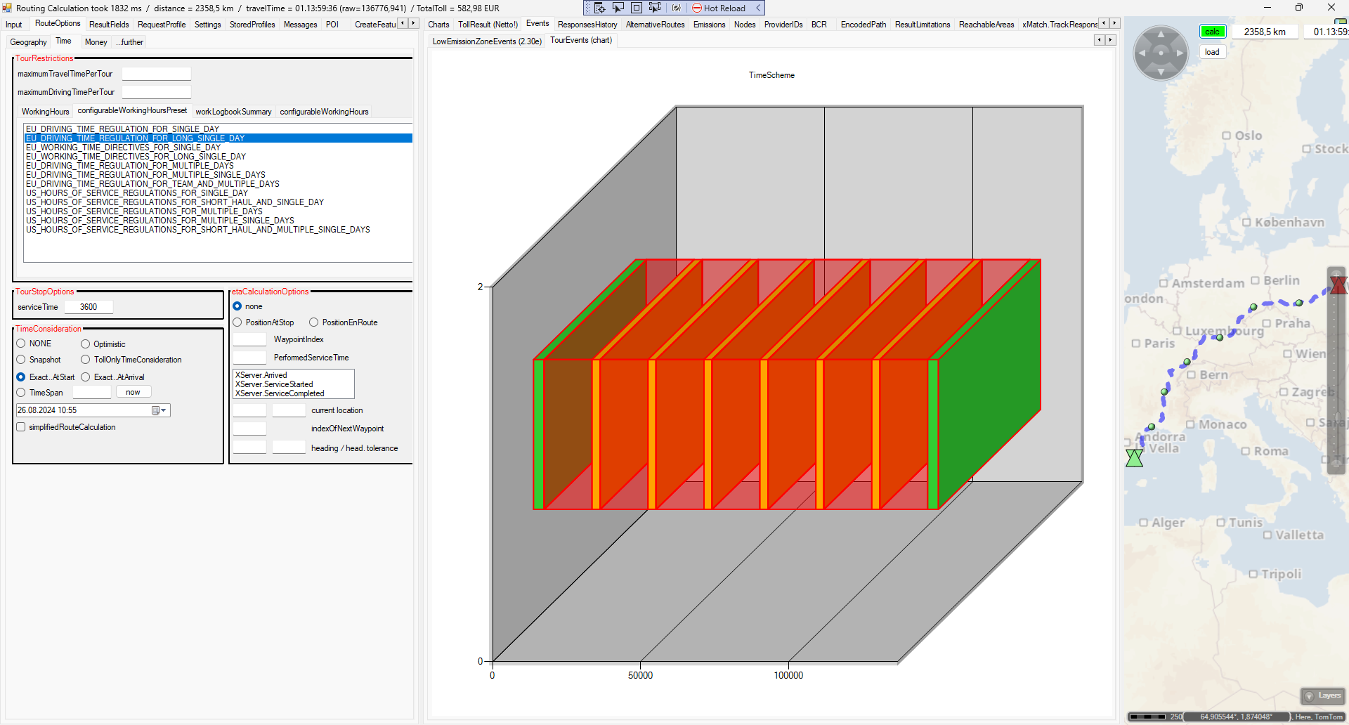

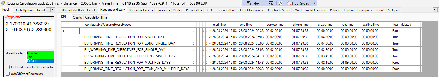

Just for the record: here's a selection of some of the com.ptvgroup.xserver.tourplanning.ConfigurableWorkingHoursPreset : The route goes from Barcelona to Wasrzaw. Service period at start and end = 3600secs.
Technical Concept: Drivers' Working Hours
As you can see: some of the presets cause VIOLATIONS on the tour because of exceedance of drivers "single day" working period.
NONE
NONE
EU_DRIVING_TIME_REGULATION_FOR_SINGLE_DAY
EU_WORKING_TIME_DIRECTIVES_FOR_SINGLE_DAY
EU_DRIVING_TIME_REGULATION_FOR_LONG_SINGLE_DAY
EU_WORKING_TIME_DIRECTIVES_FOR_LONG_SINGLE_DAY
EU_DRIVING_TIME_REGULATION_FOR_MULTIPLE_DAYS
EU_DRIVING_TIME_REGULATION_FOR_TEAM_AND_MULTIPLE_DAYS
The most important KPIs of the scenarios in comparison
As you can see in this overview some of the routes are violating the tour constraints.
