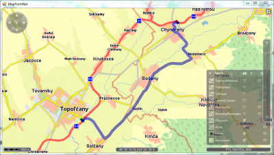

If I plan between these coordinates,
48.552293, 18.185663 -SK
48.615455, 18.277861 -SK

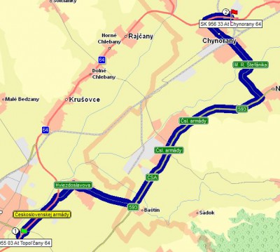

I get the following route (I linked both the PTV and googlemaps pics):
According to my research we recieve that route because on the trunk road/highway line next to the highlighted has a 50 km/h speed limitation and on the country road line the speed limitation is 90 km/h.

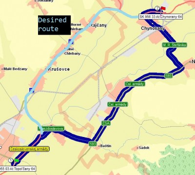

In my special case even with that speed limitation I'd prefer to use the trunk road/highway line (where the truck currently is - highlighted with light blue) instead of the (better) country road I receive.

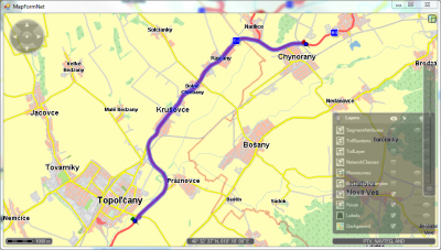

I tried to reproduce your plot but my routing track took your desired path from scratch. Which map and profile do you use?
malus on road "64" enforces a detour

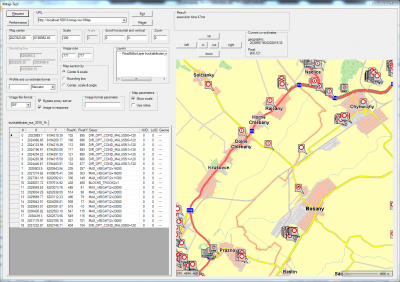

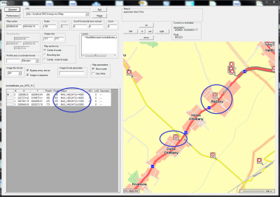

please check the attached screenshot - there are several restrictions.
truck attributes in the critical area
close-up
close-up
Best regards, Bernd

though the cause for the issue is definetly the TruckAttribute situation in the area I've been in touch with the core experts:
It is not possible to punish the change of the network class. Whether such a mechanism is helpful in general or not is probably a quite academic question and not on the roadmap.
