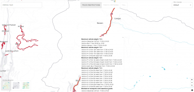

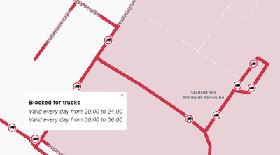

In the context of the GDF Time domain more and more often we get asked for the readable format.
In PTV Developer we offer some solution for this requirement based on the VectorMaps.
Check this Showcase Map Rendering and Geocoding (as of march 2024: english only)
Here are some examples:
Städtisches Klinikum Karlsruhe (no trucks at night time)
Some fancy restrictions at teh french-spanish border near Canejan
