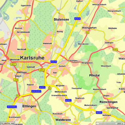

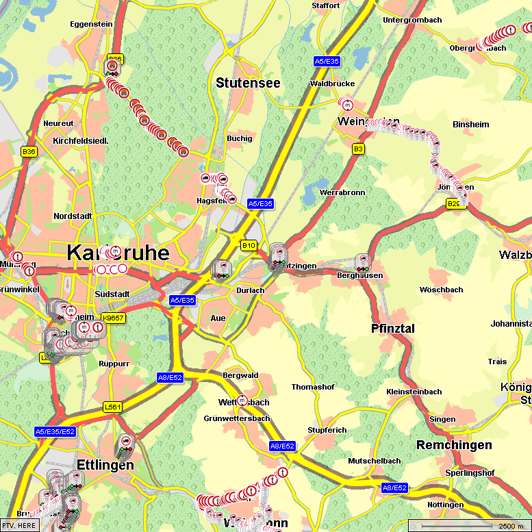

By switching the request profile to a referenced INI file you can create images such as the following ones:
SILKYSAND profile
SILKYSAND profile

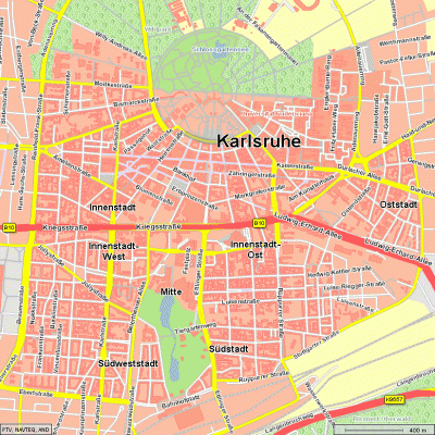

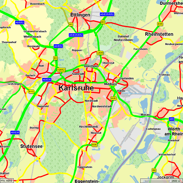

TARENDER (not standard)

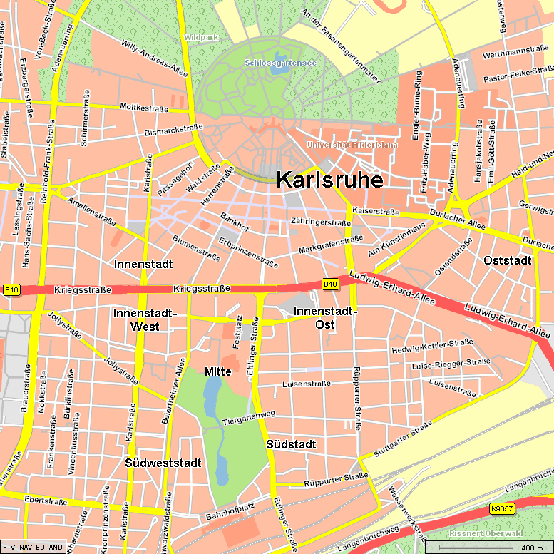

GREENZONES profile
GREENZONES profile
FOOTPRINTS profile
FOOTPRINTS profile

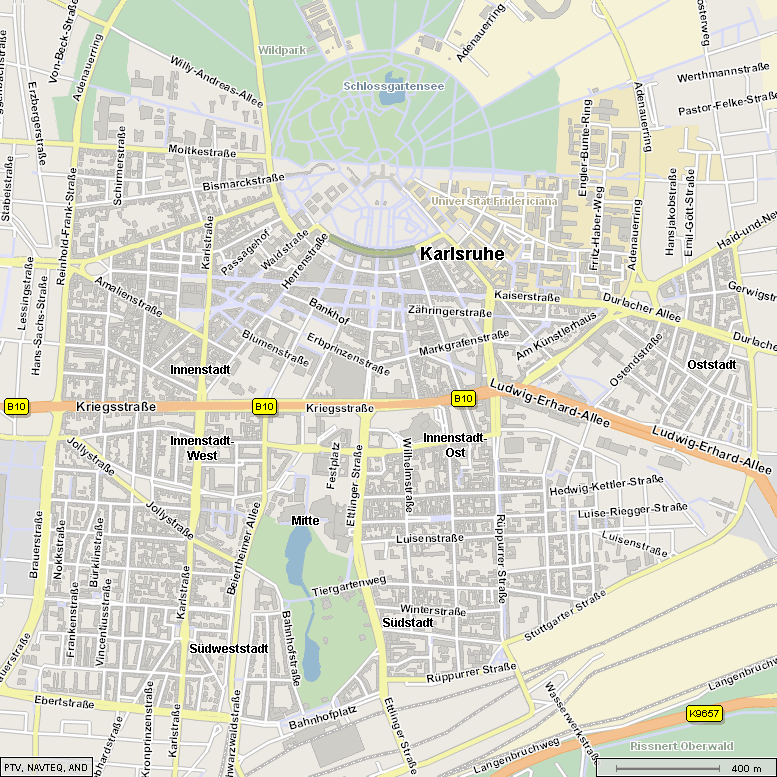

SANDBOX profile
SANDBOX profile

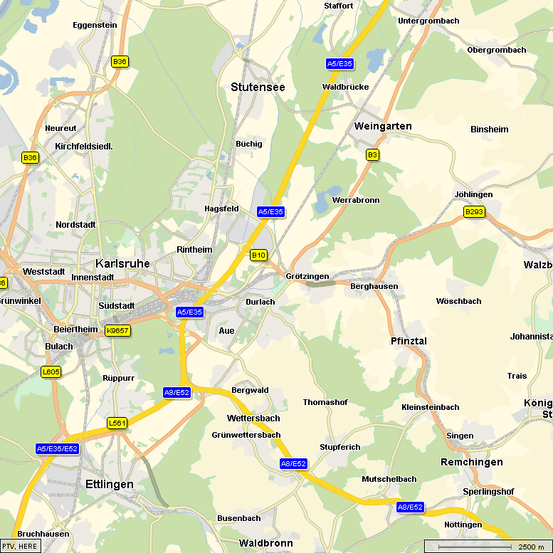

DEFAULT profile
DEFAULT profile

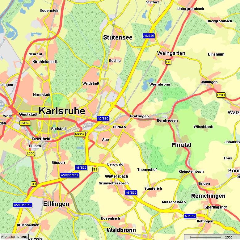

UPPERCLASSES (not standard)
