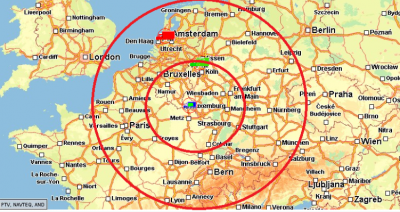

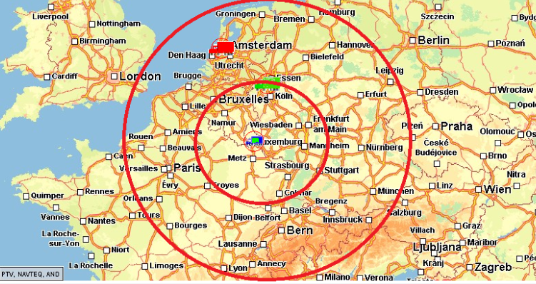

is it possible to draw a radius around a specific point on the map,
for example with a CustomLayer or GeometryLayer?
I want to have a result like in the picture.

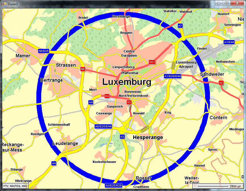

  • native xMap: the pure xMap api does not support a straight object or parameter setting that supports circles. From my perspective you have to compute a sufficient number of polygonpoints in Mercator coordinates. These points have to be provided within a standard Geometry layer or a Custom layer. Attention: if you use a coordinate format besides Mercator the shapes won't be "round". This is why you should compute in Mercator and - if necessary - transform the points into the coord format you want to use in the request. I added a spontaneous xsample here:
    XCircle.zip
    c# codesample
    (175.43 KiB) Downloaded 1085 times
    This is the result image:
    Sample output based on Mercator - circles below streets!
    List<PlainPoint> lstPlainPoints = new List<PlainPoint>();
                double arg = Math.PI * 2.0 / n;
                for (int index = 0 ; index<n ; index++)
                    lstPlainPoints.Add(new PlainPoint(){
                        x = x + r * Math.Cos(arg * index),
                        y = y + r * Math.Sin(arg*index)});

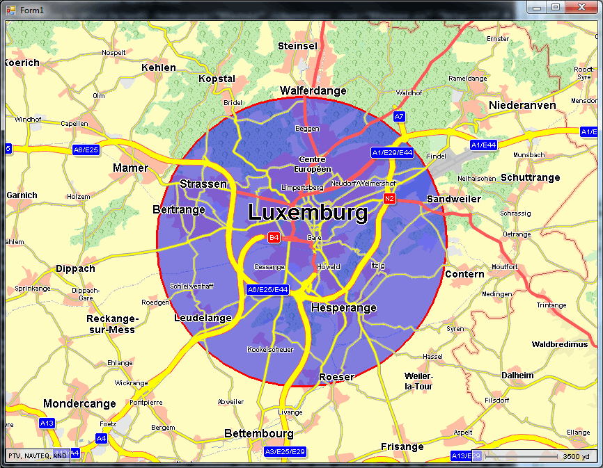

and a quick update: contains GeometryLayer, too...
GeometryLayer based circle (filled area)
XCircle.zip
C# sample with geometry layerr
(181.08 KiB) Downloaded 1264 times

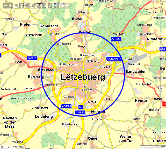

Here's a complete AjaxMaps tutorial example:
<html>
  <head>
    <!--[if IE]><script type="text/javascript" src="webcomponent/script/excanvas.js"></script><![endif]-->
    <script type="text/javascript" src="webcomponent/script/qooxdoo/script/qx-transport.js"></script>
    <script type="text/javascript" src=".qxrpc"></script>
    <script type="text/javascript" src="webcomponent/script/map.js"></script>
    <script type="text/javascript">
      function init() {
        var container =
          document.getElementById("mapContainer");
        var map =
          new com.ptvag.webcomponent.map.Map(container);
        window.onresize = function() {
          map.updateSize();
        map.setCenter({x:4303250, y:5486500});
        map.setZoom(10);
        var vectorLayer = map.getLayer("vector");
        // create circle
        var circle = new com.ptvag.webcomponent.map.vector.MeterCircle();
        circle.setX(4303250);
        circle.setY(5486500);
        circle.setColor("rgb(0,0,255)");
        circle.setMeterSize(10000);  // 10 km diameter
        // customize drawing (line instead of fill)
        CoordUtil = com.ptvag.webcomponent.map.CoordUtil;
        circle.draw = function(container, topLevelContainer, ctx,
                               mapLeft, mapTop, mapZoom) {
            var suPoint = {x:circle.getX(), y:circle.getY()};
            var pixCoords = CoordUtil.smartUnit2Pixel(suPoint, mapZoom);
            var realX = pixCoords.x - mapLeft + circle.getFlexX();
            var realY = mapTop - pixCoords.y + circle.getFlexY();
            var radius = circle.calculatePixelRadius(mapLeft, mapTop, mapZoom);
            ctx.strokeStyle = circle.getColor();
            ctx.lineWidth = 4;
            ctx.beginPath();
            ctx.moveTo(realX + radius, realY);
            ctx.arc(realX, realY, radius, 0, 2*Math.PI, false);
            ctx.stroke();
        // make circle visible
        vectorLayer.addElement(circle);
      qxp.dev.log.Logger.ROOT_LOGGER.setMinLevel(qxp.dev.log.Logger.LEVEL_INFO);
      qxp.dev.log.Logger.getClassLogger(qxp.core.Init).setMinLevel(qxp.dev.log.Logger.LEVEL_ERROR);
    </script>
  </head>
  <body onload="init()">
    <div id="mapContainer"
      style="width:100%;height:100%">
    </div>
  </body>
</html>
