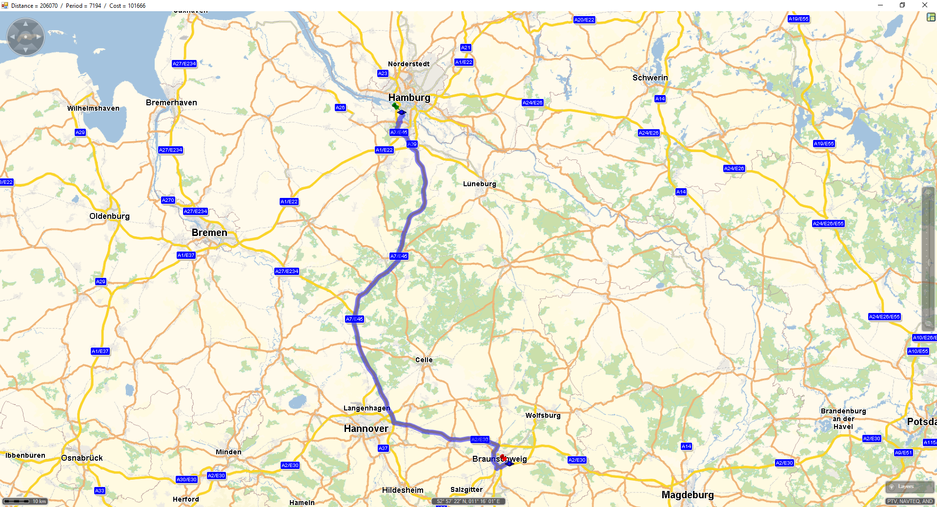

Of course the next question is then "why does the router not use the same streets?"
And then it comes to speed values and optimization. Here's another example:
DIRDistancePeriodCOSTTrack
N to S2060707194101666WEST
N to S +1862097733102025EAST
S to N1842617786102031EAST
S to N +2046477370102765WEST
So sometimes adding waypoints creates better distances and worsens the period. If the route is focused on period the +ROUTE is not better then.
South to North plus waypoint
South to North
South to North
North to South plus additional waypoint
North to South without any additional waypoints
