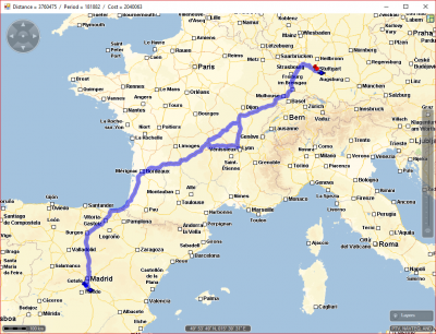

The geometry of the routes is not the same, e.g. other roads are used.
Route from Stuttgart to Madrid and back.<br />In the region of Lyon the router takes different superregional tracks
Of course the next question is then "why does the router not use the same streets?"

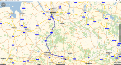

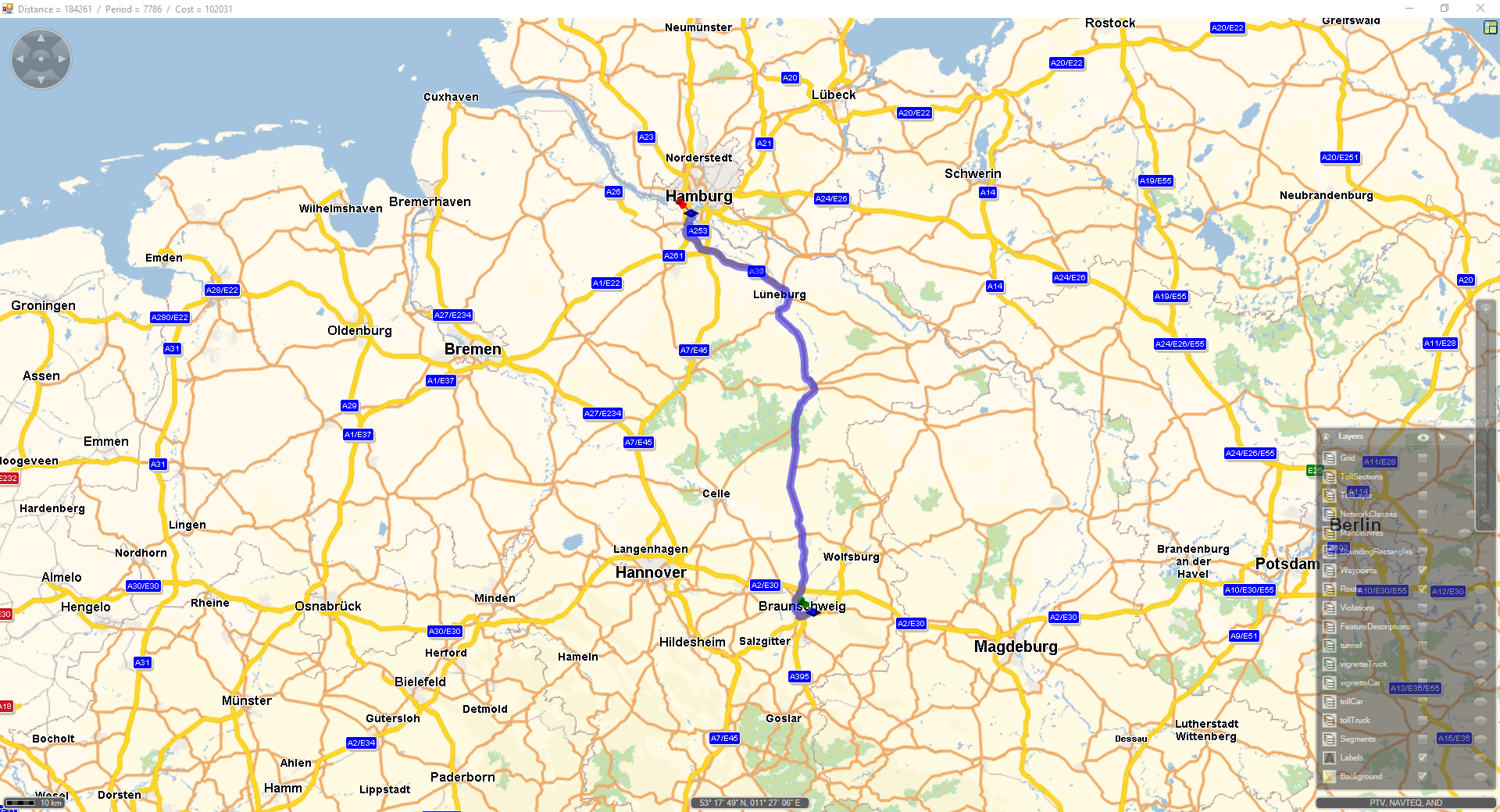

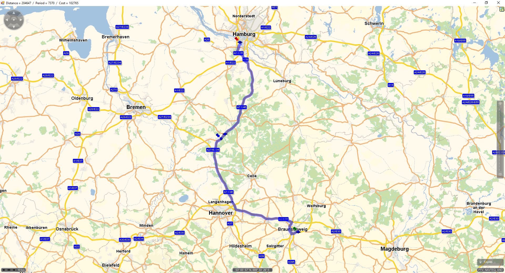

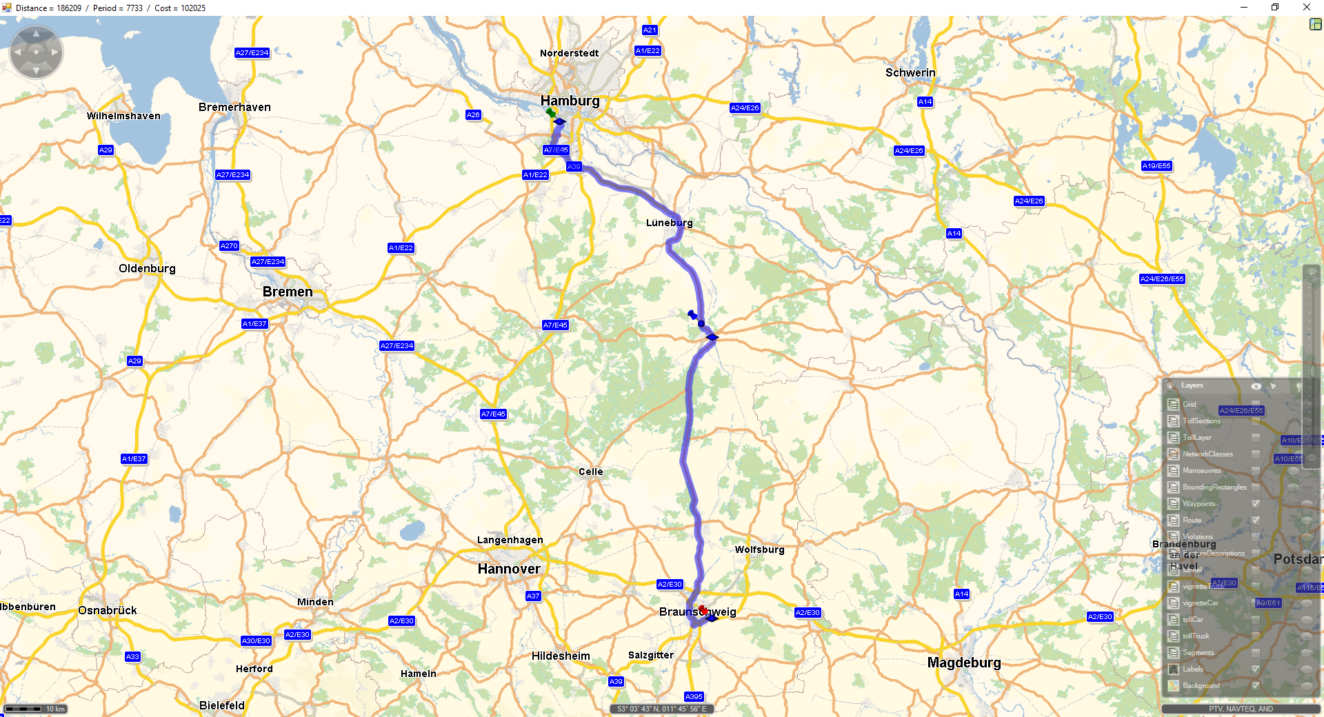

And then it comes to speed values and optimization. Here's another example:
DIRDistancePeriodCOSTTrack
N to S2060707194101666WEST
N to S +1862097733102025EAST
S to N1842617786102031EAST
S to N +2046477370102765WEST
So sometimes adding waypoints creates better distances and worsens the period. If the route is focused on period the +ROUTE is not better then.
South to North plus waypoint
South to North
South to North

North to South without any additional waypoints

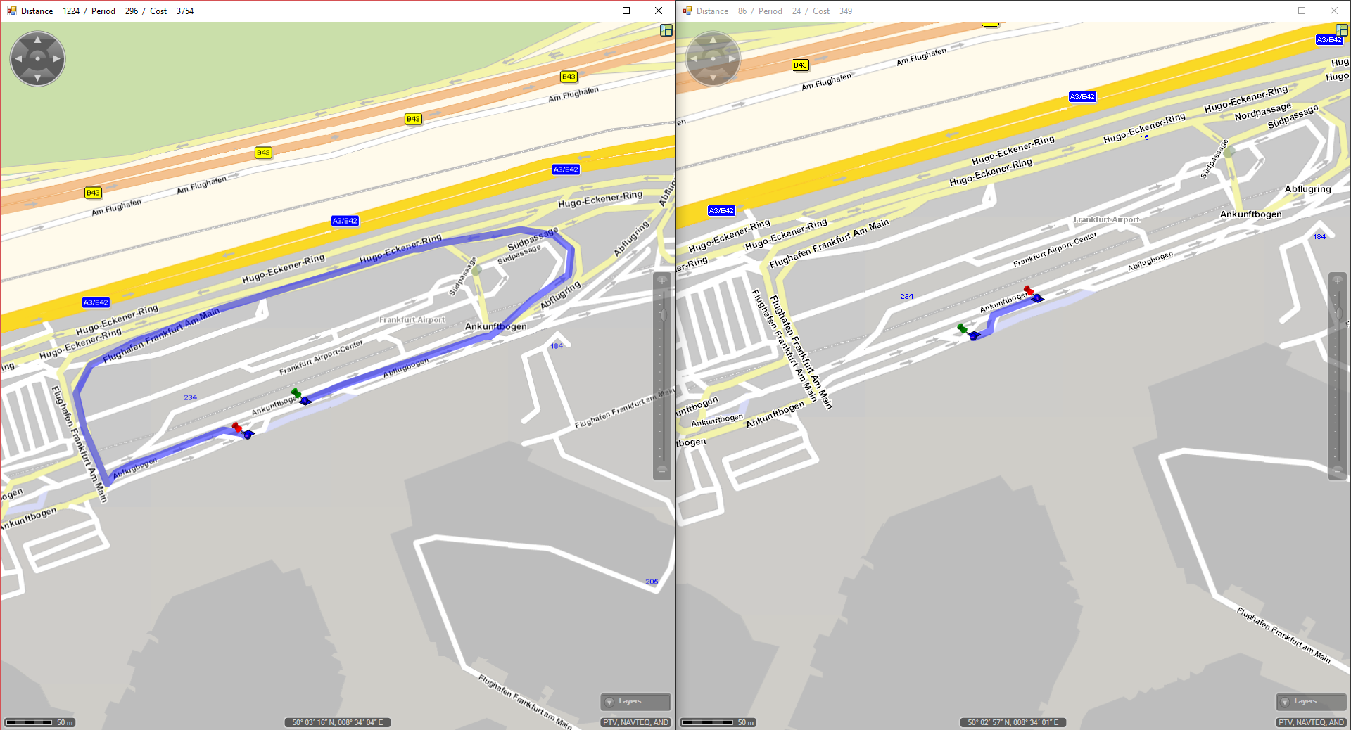

"Frankfurt Abflugbogen" (Frankfurt Airport: Departure) to "Frankfurt Ankunftbogen" (Frankfurt Airpoirt, Arrivals)
Absolute difference is not that big but from a relative perspective it is enormous:
1.200m versus 86m ;-)
