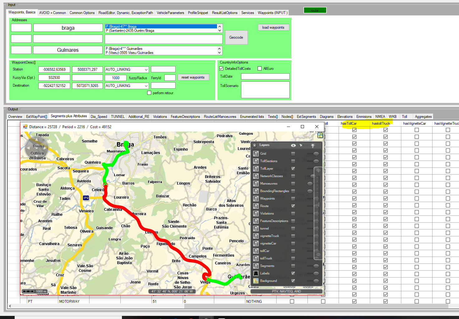

Segments with toll are highlighted. But there are no toll prices in the response.
Posts: 3052
Re: Toll costs details (c#) (xsers-1330)
in the meantime we made some analysis:
  • Our data experts were able to reproduce
  • The provider data does not mention toll on the given section
  • Technically spoken: the server does a proper job
We will now check whether there's toll on that track (server response wrong, expectation correct) or not (server response proper, expectations wrong).
